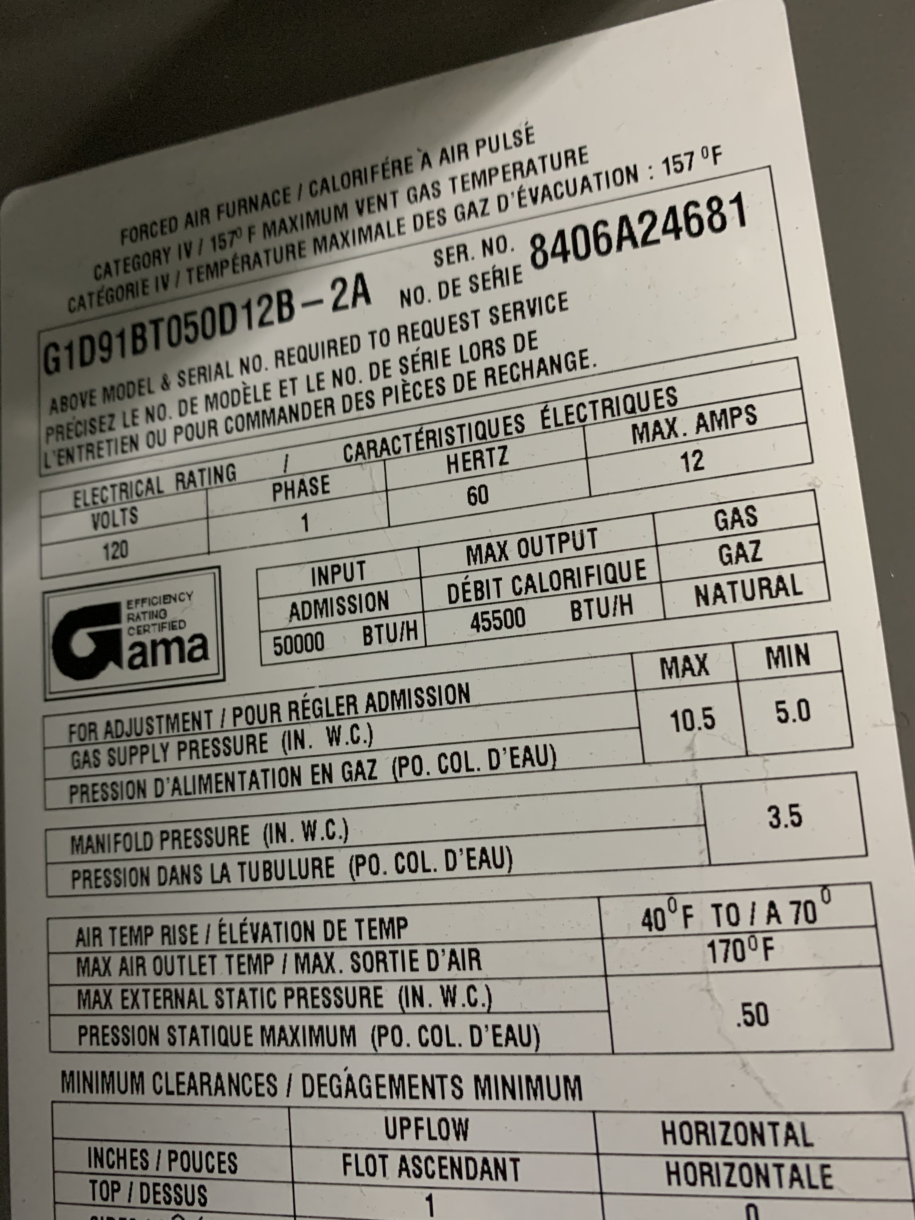

Is this what I need for someone to confirm with furnace age?
Can someone help me on the year this furnace was manufactured? I hope this helps! I’m thinking 2006!
Not 100% sure of top photo, thought maybe it would help but did not make sense to me what it was for, the bottom two photos were behind the panel
you are correct Greg. It is 2006. It is the 3rd and 4th digit of the serial #. C is the Month-March

Joe is not exactly correct.
The Furnace is 2006, but January (A) not March.
The first pic is of the Air Handler (Evaporator Coil).
The 2nd and 3rd pics are of the Furnace.
Thanks Jeff for pointing out that its the air handler info.

Yep, 2006. If I’m not mistaken, I printed up a general description of many manufacturers nomenclature designations for each of their respective components. But Joseph is correct. Rule of thumb says it’s the third and fourth digits that indicate the year.
