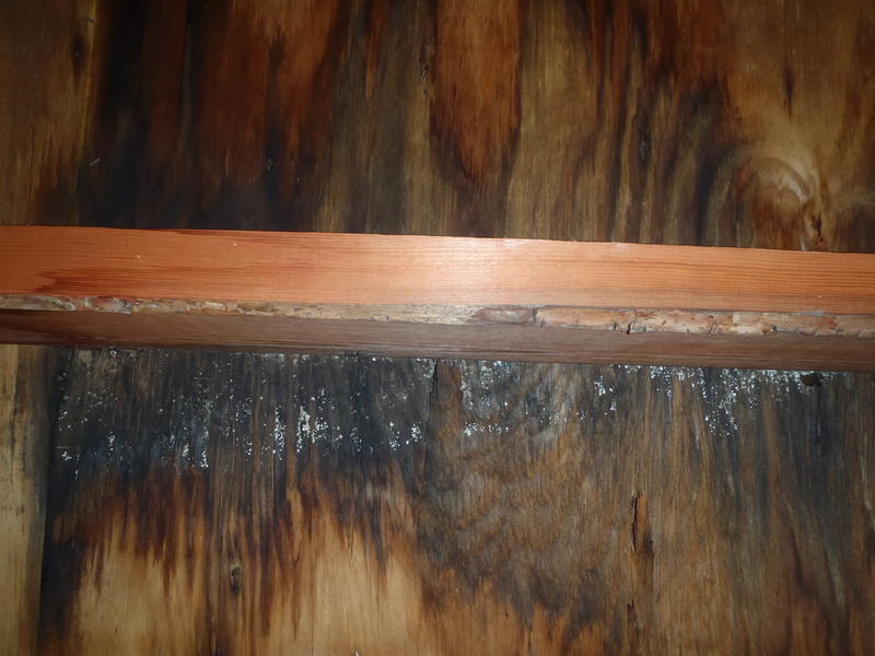

Saw this little nail and found this inside.
Yep, that’s all it takes…
That’s a great example photo. I get annoyed when builders complain because they are asked to seal nail heads for a new construction punch list.
“I’ve never had a nail head leak!”
“That’s because you’re done with the house after the one-year warranty.”
