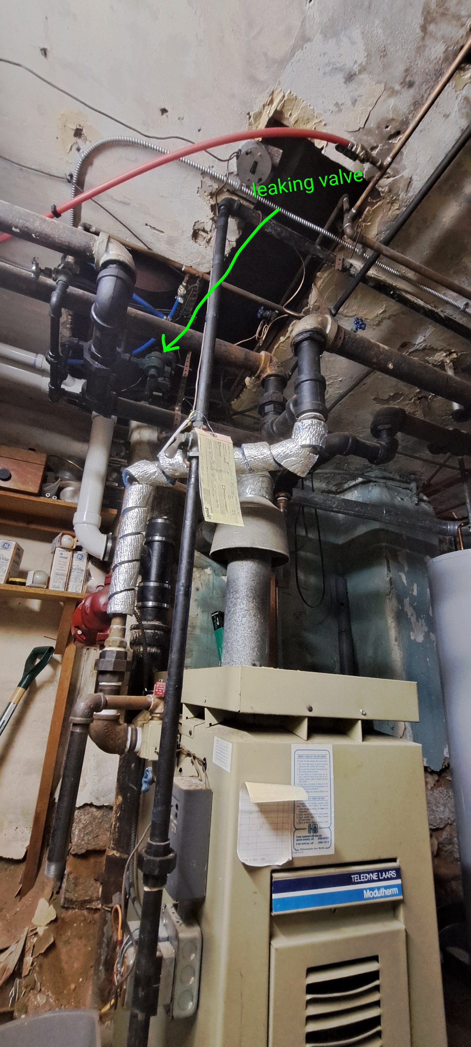

Last year, a gas company guy told me that my 40+ yo Teledyne Laars boiler was working well, that the newer ones are not as well made, and recommended keeping the Teledyne until it gives out. Unfortunately, we need a new expansion tank, some isolation valves, and could use a new pressure gauge and relief valve. The plumber strongly recommends replacing the boiler while we’re at it. Just wondering if anyone in this situation might try to keep the old boiler. Thanks for any thoughts.

So, one issue is that the pressure gauge doesn’t work. I was told that it might not be possible to remove the gauge, or for that matter, the pressure relief valve, after so many decades, without breaking the unit. The pressure gauge hasn’t been too much of an issue, but once the whole system is drained, is it possible to safely refill it without a working pressure gauge? Or does the gauge really have to be replaced? Not sure if the pressure relief valve actually has to be replaced either, it’s just very old.
The pressure gauge and “pressure relief valve” could very possibly be replaced in a few minutes without “draining the whole system”. Once again lots of variables. Any photos of the installation may help with more concise answers. You definitely need other opinions/quotes.

The system has to be drained because a valve that I presume was previously been connected to an expansion tank in the ceiling has started to leak, and there are no isolation valves. (The expansion tank was disconnected decades ago and never replaced). A separate issue is whether the gauge and relief valve can be detached without breaking the unit (because the threads may have become stuck together over time…?).
The pressure relief valve should probably be replaced. They don’t last forever. The pressure gauge really doesn’t matter if you have a known, working relief valve.
I understand what they are saying about the pipe. That said, I see a union and other joints and when you’re working with black iron pipe, you can usually get it apart with some heat. Failing that, you cut it off and thread a new union on.
Seriously, anyone who has worked with black pipe won’t have any issue dealing with this. You just need to have the right tools to cut new threads.
I don’t recall whether or not those systems came with a bladder tank or just a steel tank, but do not run it without one, your heat exchanger will blow out pretty quickly. At this time, I wouldn’t run any boiler without a known, working PRV. If they have to plumb in a PRV they can plumb in a T for the gauge ahead of it and leave the original gauge in place.

Also, it looks like the leaking valve would be called a pressure reducing valve?
