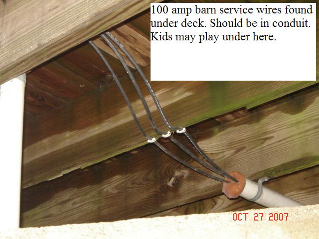

Inspection today found this 100 amp secondary service to a barn from the house. House was built in 1996 barn was buit a few years later. Would you want your kids playing here?

What type of wire is that, doesn’t look like thhn. It could be wire trough wire, I forget the name, but I would not have a problem with it.

That’s not cable. Those are conductors, and SHOULD be in conduit in that installation.
Could very well be small URD, which IS direct burial rated but MUST be protected where exposed.
Good call Scott.
Could also be SJ wire. None the less it should be protected.
If it were SJ there would be a litany of other violations associated with this installation.
Sorry getting to this one late…I agree with the SPEEDSTER on this one…more than likely direct bury rated wires that came into the dwelling from the conduit and then they did not continue it to the enclosure for the barn. They indeed need to be protected…
Also looks like they used Plumbing Pipe on what they DID protect…hmmmm

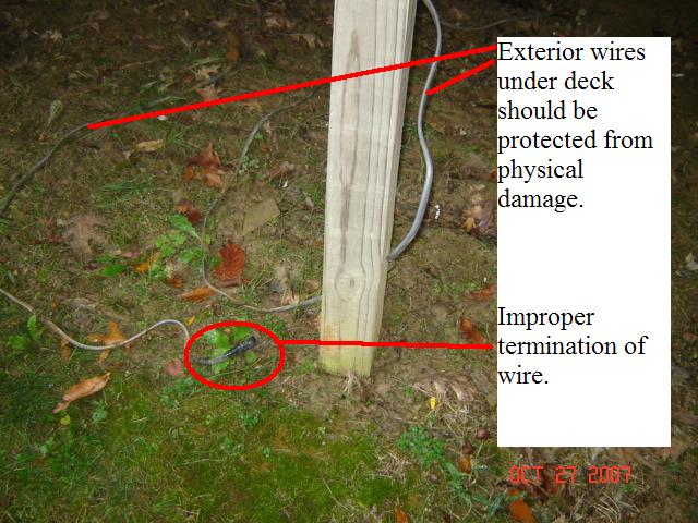

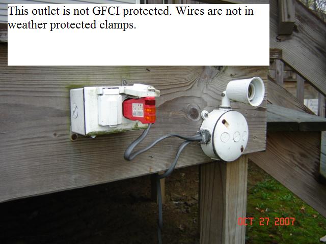

Direct bury wires there, and yes DWV pipe used. I see that all the time here. Just could’nt believe they left it exposed under the deck like that. 3’ of crawl space there. The couples grand kids would love that area. Out the back of the deck it sloped down to the river. Kids would have been there all the time. Here is what else was at the back of the deck.
This is classic DIY stuff.
They know enough to make it work, but not enough to make it safe.

well…hopefully when you see Plumbing Pipe being used for electrical conduit…you call that out also…if you see it all the time we have a serial DIYer on the loose…lol
Actually if that is really USE I would question the fact that it is not “outside the building”
It’s been years and years since USE hasn’t also been dual rated as other conductor types such as RHHW and XHHW.
…and that installation is relatively new due to the cheesy DIY “two-nail” romex staples used.
