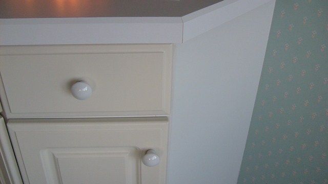

These cabinets are in a Florida home that is 18 years old. They used to be white like the laminate. The same fading happened to the old range and microwave. They do not have sunlight hitting them. House is vacant in the summer with air kept at 80 degrees.
I’m interested in finding out why they fade to a yellowish color.
Here are some pictures:

Different materials, Formica and thermofoil?
That’s the direction I was thinking, John, but the range and microwave faded substantially, too. The appliances are gone now but maybe they only faded at the plastic parts. I don’t know for sure.

The doors and the cabinets were not painted with the same material.
Packaged pre finished doors perhaps.
No paint…laminate and plastic.
I think John may have it:
I don’t see much in the line of PVC cabinetry but a Google search indicated that the non-fade warranty is about 5 years.
I don’t know how the Florida weather affects that exactly but it seems to speed it up. Plastics all around the home seem yellow when they were once white…intercom…wall phones…stool handles and seats, etc.

If base is Formica and the doors are a polymer the polymer will fade over time while Formica always retains its color.
Polymers require a catalyst to harden and the surface often retains a certain porosity if not cured properly.
Take a look at any polyester resin (clear) and you will notice a Amber tone.
Learned this while building fiberglass mixed media pieces.
Too sum up plastic is not a totally hard surface.

I just took the door pull off and can see the MDF underneath in the bolt hole, so, as I said, I think John has the material pegged in post 3. The fading/yellowing is obvious…I just don’t understand why it appears to occur faster in the hot humid climates.
Possible yellowing from adhesives (vinyl floors, laminate countertops, etc), and/or indoor air pollutants reacting with plastics.

This is a crazy one I ran across that could be applied to other plastics. Possibly normal aging of plastics due to exposure to oxygen, heat and UV.
