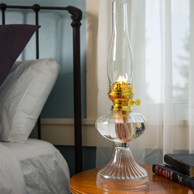

No we had Aladdin Lamps and I still have a few , Had over 20 at one time .
This is .Model B Alacite Lincoln Drape I have 2
