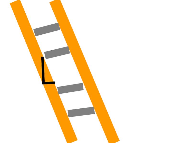

Most fiberglass ladders also have a small l shaped icon on the rail that will go perfectly vertical (straight up and down) when the correct angle is placed so that guess work s not needed.
I also recommend claws at the bottom to dig into ice and dirt to prevent slippage.
Done. Can you post a link that has more info about the vertical icon? Sounds interesting.

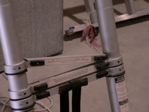

That fold up Warner er Werner is a scary beast… Talk about loose joints and height?
The longer they get the “looser” they feel… Cheap ladder are expensive in other way… HOSPITAL vist…
That"s why I am going to be using the Aerostar once snow hits.

I pulled my van out of the garage to get to my fiberglass ladder (started after sitting all summer)(92 Ford Aerostar).
Feel bad because the darn sticker is peeled off.
Ok now I feel like a lier and do not see a picture of it anywhere on the internet ,so I will go to the store and take a pic to save face.

Here you go Bob. I was taught the same way as this and never had a problem.
Forgot the link.
http://www.rd.com/advice-and-know-how/illustrated-tips-and-techniques-for-safe-extension-ladder-setup-and-use/article117162.html

Does not show the sticker.
Damn, your demanding Bob. :mrgreen::wink: It’s on the other side of the ladder.
most people always wonder what is leaning to far on a ladder? i would like to see that defined. the last saftey course i took the osha instructer cited the belt buckle rule. meaning that your belt buckle shall not pass outside of the rails of the ladder
Here you go Bob, and man, I hope this is what you wanted. :mrgreen::wink:
http://www.duosafety.com/images/fll.jpg
Meanwhile if you get the perfect angle you can take a Permanant Marker and a straight edge to mark a line on the side rail.
Put it about shoulder high and next time you pull up the ladder you can line it up easy.
