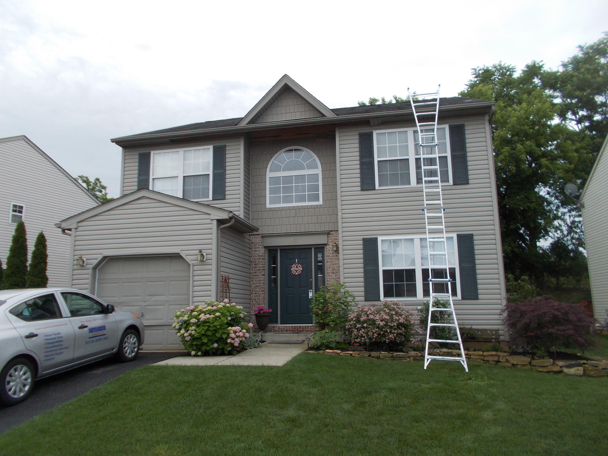

The biggest problem with telesteps or extend and climb ladders is failing to ensure ALL the locks are in place. I’ve used both for 15 years and have yet to have a problem.

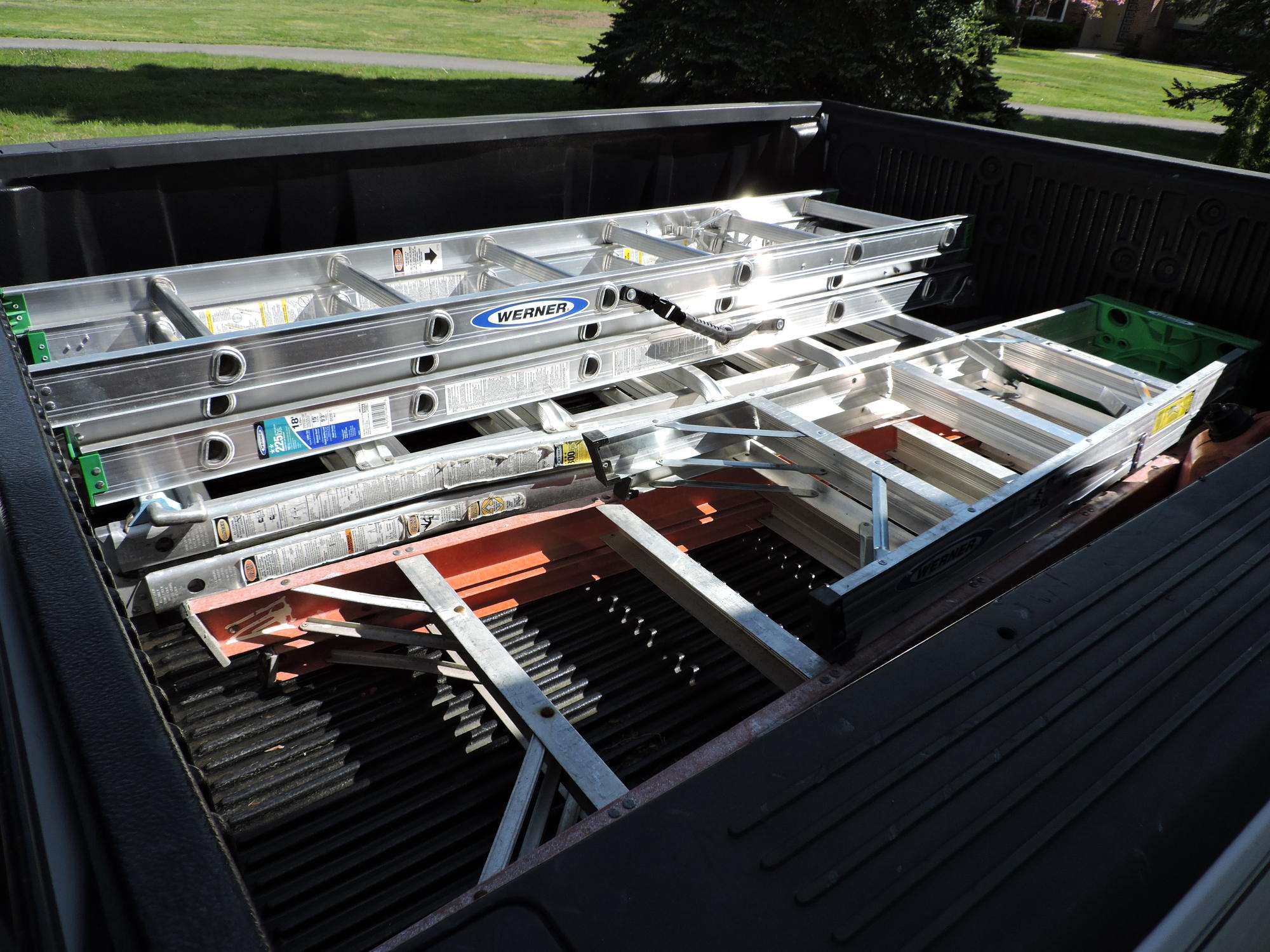

When I closed my construction construction company, I sold my vans, racks, ladders, and bought an F-150. Got the Werner 18’ 3-section extension and the Werner 26’ telescoping multi-position type IA ladder (62lb) for my inspections. They both fold up to fit in my short bed perfectly. Anything higher than 26’ and I’m not going up (too old and bad knees).
