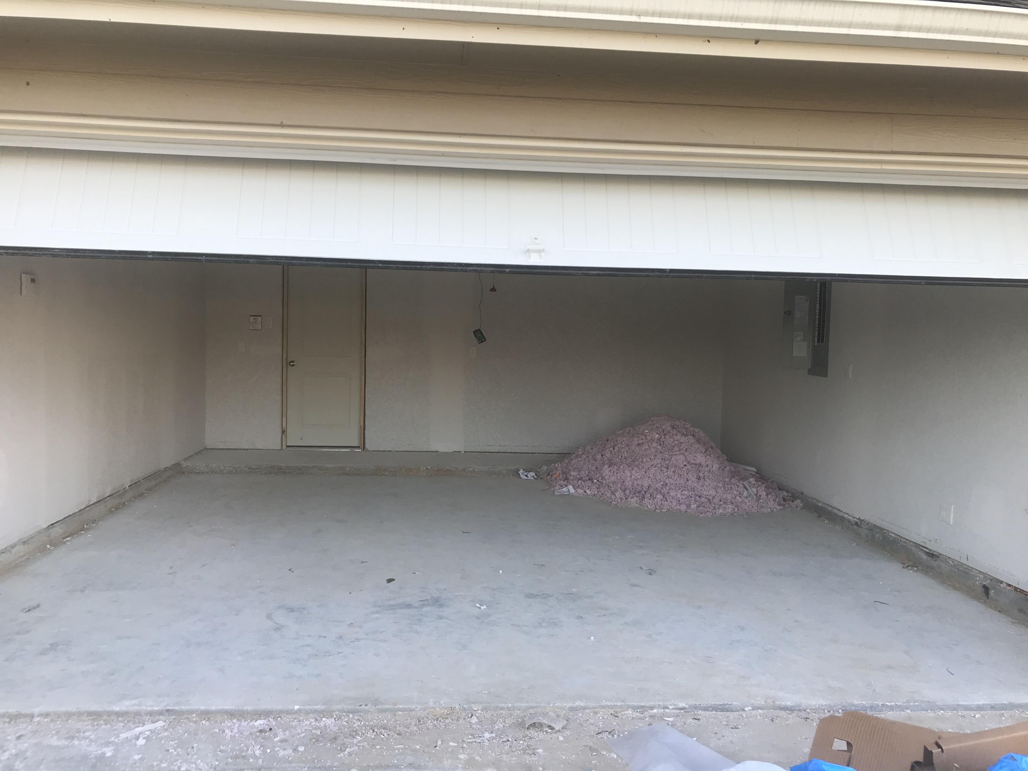

Hi everyone, I am looking at a new house now. It was built in 2019 and had been builder’s model home and office until a couple weeks ago. The attached garage area was their office and it is being converted back to garage now.
While looking at the foundation on interior and exterior side of the garage, I saw multiple large and deep horizontal cracks (3 inch deep somewhere). One corner spot had been “fixed” recently. But it appears cracks again. My questions:
1. Are these cracks dangerous sign?assume the house is not settled yet…
2. Is it normal for a new home or any home?
3. What’s the proper way to get it fixed?
Many thanks! I like this house very much. But cracks could be deal breaker. Please share your knowledge and educate me!

Do you have pictures of the same areas from a little further away so we get a better sense of what and where we are looking at? That would help. Where you are located would also help.

@mcyr thanks!crack photos were taken at the garage foundation, right and left side. I have a photo when drive way was under construction. House is in Houston area

Nice picture, but where are the cracks in relation to it?
You might have some chiming in from your area.

Would this help? Thanks. Cracks occurred at the side foundation below garage walls

Being new construction, looks like they got caught by a freeze during the winter months. Being that its a one story garage and not much load, probably not gonna have issues. Some patchwork and you should be okay.

I agree, Stephen. That or damage when the forms were removed when to green. All the loose material would have to be removed and patched with the proper material and bonding agents and it should be fine. Should not affect the structural capacity of the wall.

@spayson thanks. It is a small two story home. Just the length and depth in certain spot got my concerns…

Wow. Take caution. Get a structural engineer to look at that. If the concrete deterioration has extended into the embedment volume of any of the sill anchors, you have a problem.

Assuming that correct anchor bolts were used, they would extend much deeper than those cracks.

@spayson thanks Steve. One spot crack pretty big and deep. I can stick my finger into it for about 3 inches. ![image](https://global.discourse-cdn.com/internachi/original/3X/1/3/13b93301f177972a0611d69c8497943225fd61b4.jpeg)

> [@spayson](#):
Yes, but if the top 2 to 3 inches of that foundation continue to crumble, having the lower 8 to 10 inches still embedded is not going to keep the sill plate from moving. Instead of a sandwich of anchor nut-sill-concrete, you’ll get anchor nut-sill-loose rubble-concrete. Parking decks have collapsed from a similar mechanism.
