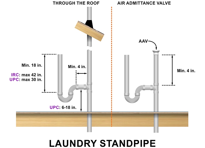

Can InterNachi provide a graphic of a laundry tub waste line? I would like to know what one looks like ;). Thank you!

Thank you for the link to the images. Actually the following youtube video “Install wall hung laundry tub, standpipe, air admittance valve” helped me understand what a “laundry tub waste line” is https://www.youtube.com/watch?v=
It would be very nice if such a graphic was provided in order to visualize the dimensions outlined in the text.

(Roy Lewis, CMI - North Florida Inspector) #5
That to me sounds like a clothes washer standpipe…
(Bradley K. Toye, CMI) #6
Agreed. The stand pipe is for the washer. The drain for a laundry tub has the same standards as any other sink in the home.

Here is another image…

Wasn’t quite sure what he wanted.
