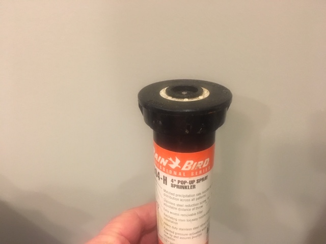

The attached spray sprinkler is manufactured by Rain Bird it is a 4" pop-up sprinkler. This model sprays in a half round pattern which is typically used along fences and foundation walls. The head is designed to spray a radius of 12’ with a pressure of 20 psi. The head has an adjustment screw in the center of the head to adjust the flow of water.

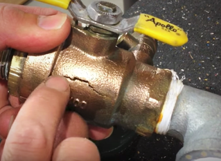

This valve supplying water to a lawn irrigation system is cracked. The cracking is most likely due to freezing. It is recommended that the homeowner hire a qualified professional to winterize the lawn irrigation system each year to protect the system.
*Full disclosure: this image was found online (credit: www.outbacklandscapeinc.com), not taken by myself. In the course of my inspections, I have yet to inspect a home with a lawn irrigation system. The comments and thoughts and recommendations are mine.

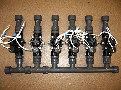

Its hard to be an expert in irrigation manifold when they are literally hundreds of different styles and manufacturers. Th most important part of inspecting the irrigation manifold is insuring you here the solonoids activate the zone and that there are no cracks/defects when visual inspection happens
