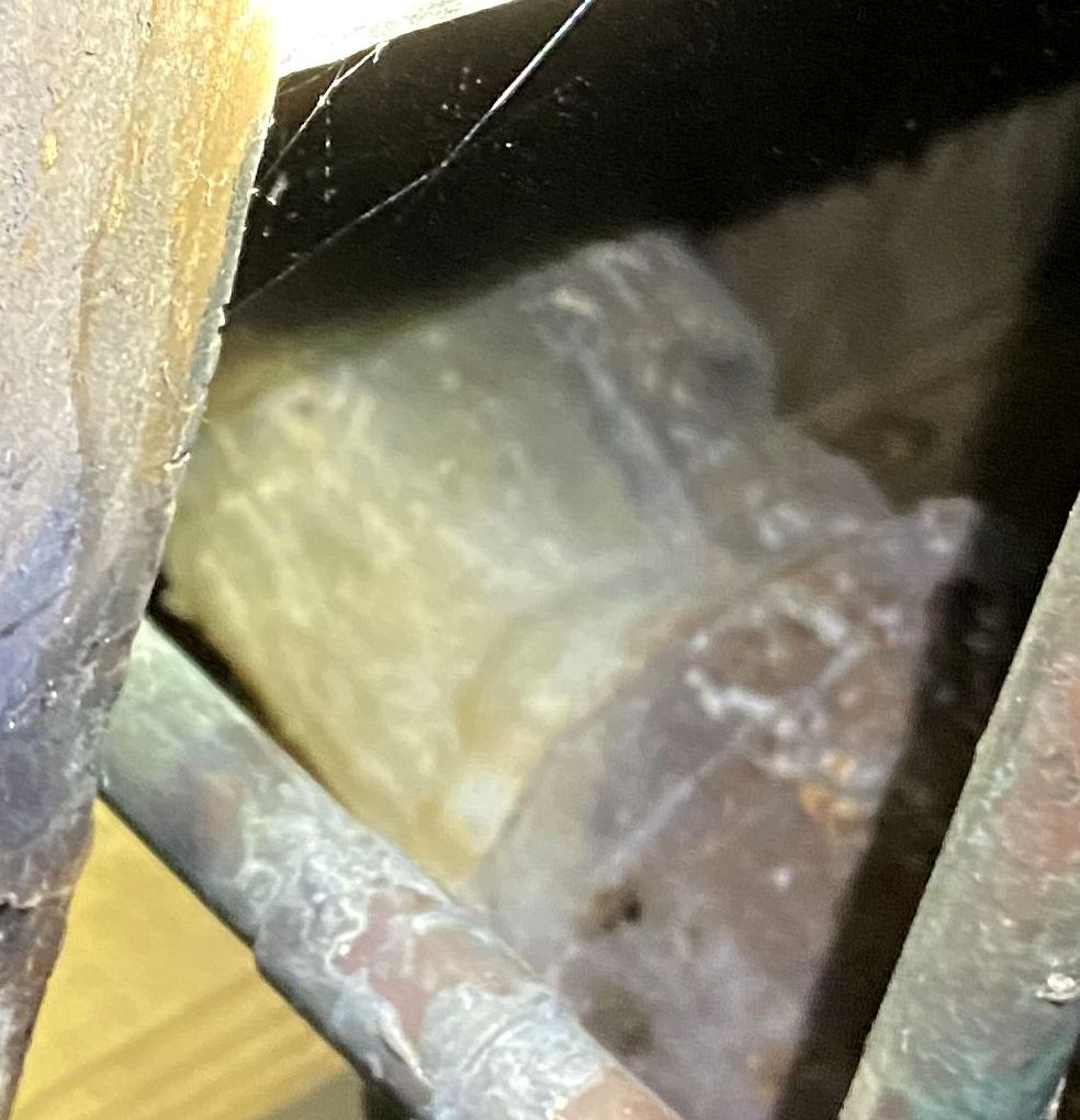

Had a tough time getting a good photo but is this a lead drain pipe up at the top? Never have encountered lead pipes before but remember learning that they’re bubbled up like this sometimes.
Looks like it to me.
Just scrape it a little. If it is bright silver colored then it is lead.
I have to +1 @jdepiero on this.
Also, since lead drain pipes do not supply potable water, it poses no direct hazard to the home owner. I sometimes overlook the basis of a concern as I am thinking it through. :grinning:
