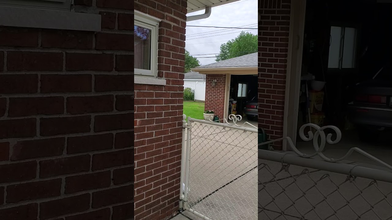

Leaky basement back corner under driveway
some fools would recommend mudjacking slab(s) or pouring new mud n some other would be dumb enough to recomennd an interior basement drainage system $$$
BEFORE she answered the door, before i went in basement, quick observation of where the water may be FIRST entering
and here, just did a 2 minute water test with a hose to correctly identify where the water is entering - there will be 1 or more other deteriorated mortar joints BELOW what you see and might be 1 or more gaps at-along the top of the poured foundation wall which is BELOW the driveway, dig?
