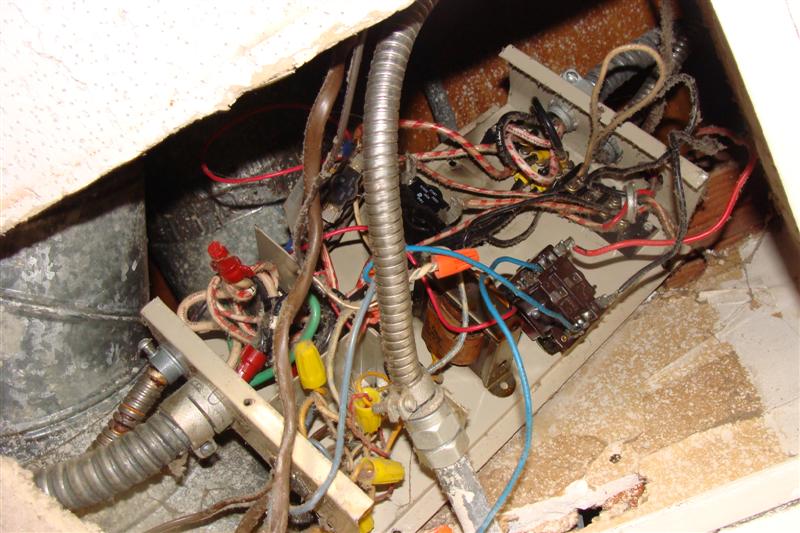

That I don’t need to inspect the roof because the roof is maintained by the homeowners association.
I just smiled and stated well there may be something on the roof that the home owners association needs to be aware of. The realtor also stated that the other inspectors in this particular city did not inspect the roofs on these town houses. My second statement was while gritting my teeth well young lady you have never had me as an inspector before:shock: end of conversation;-) Here are some pics of just a few items found on the roof.
Pic 4 was the control panel for the electrical fan unit in the ceiling with strip heat What ever happened to pride in workmanship it was hanging by a nail from the floor joist
