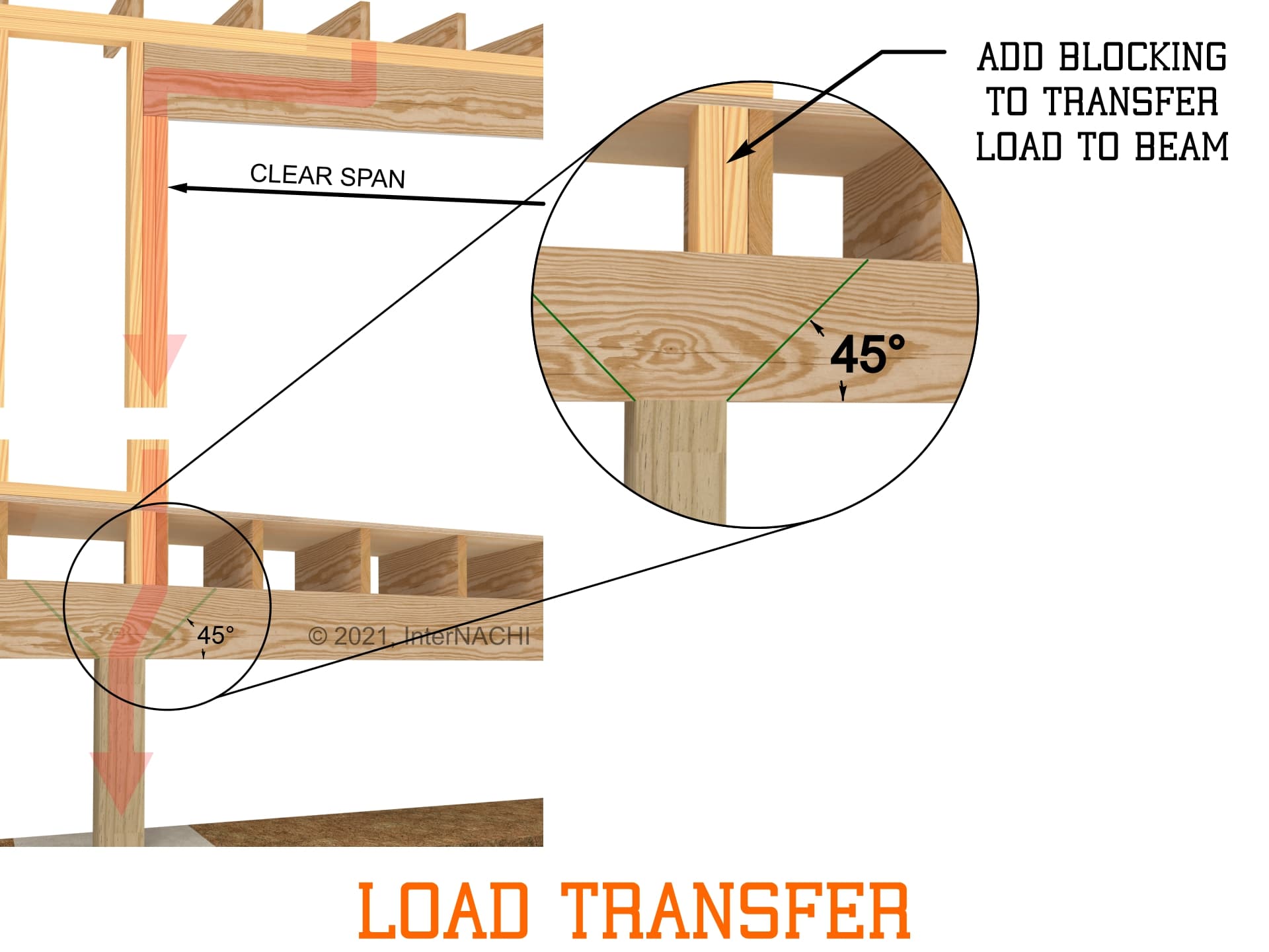

Load Transfer from Load Bearing Wall Removal
Here is a graphic showing how a header beam transfers the load down to the footing through blocking added under the floor. This is a special case where vertical loads within the 45° shear zone does not typically need a separate column and footing.
