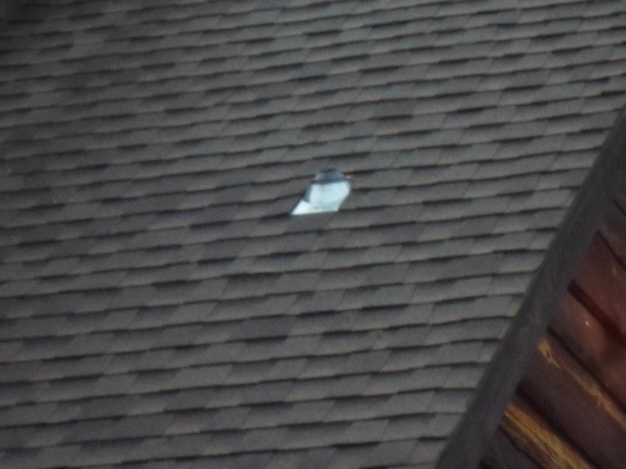

In going through this Log Home Certification, there are many things that one learns in dealing with log homes. This particular issue isn’t quite having to do with rot or structural issues, but merely a failure issue that can affect the rest of the home.
This Vent pipe has sheared off due to snow load and will cause water to enter the attic area where there is a vaulted ceiling and cause related issues to the finish materials inside the home. Recommend having the homeowner repair the issues to reduce further potential water related issues in this area and for continued functionality of the vent pipe for its’ intended use.
