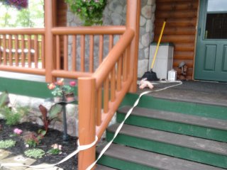

On this inspection of a log home in Dresser, WI. the components I picked are the front steps and stair railings and also deck rails. As I was inspecting these components I saw that the railings on both the porch and front stair rails were below 36 inches and the balusters were farther then 4 inches apart. There were no safety graspable stair railings running along the log rail and because the log rail is too large to wrap your hand around,a smaller railing is needed. I also found wood rot at the bottom of stair posts and on the bottom of the stairs which both were in contact with soil. I marked all these in my inspection report to client.
4 inches for guardrails
4 3/8 inches for stairway handrail assemblies
