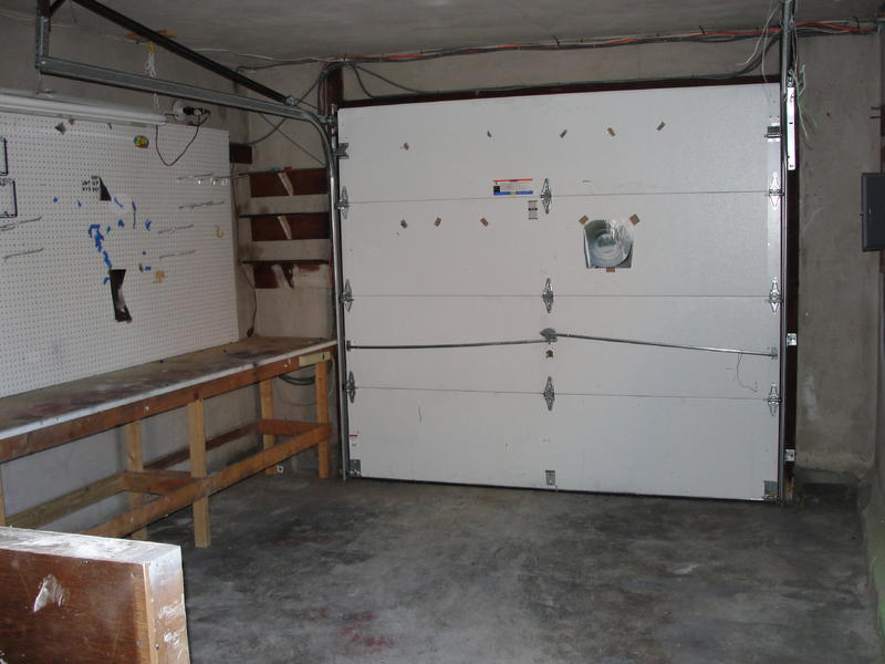

I was at a house yesterday and in the garage there was only 13 feet from the garage door to the stair guardrail and stairs leading to the basement. The only cars I know that would fit would be a Daewoo, An Old Chevy Chevette or a horse.Our SUV is 15 feet long. Most people around here have larger cars (SUVs) compared to compact cars. Is there anything that can be done besides filling in the whole stair well with concrete?? Thanks Rick

Can’t a metal plate be installed over the area. So that it can be lifted if access to the basement is needed? Just an idea. Always mention to get it done by the proper licensed tradesman. Just an idea…but is that mold I see on the walls?

Ok, just filling in the stairwell with concrete would NOT be a good idea. That would be adding a lot of weight in a small area, which could cause vertical settlement issues. Further, the walls along the stairwell are concrete block and might not be able to take the lateral forces applied against them, causing them to buckle outward.
You did not say whether you are buying or just inspecting the property. If you are buying it, get an engineer to design a fix if you want more space. If you are inspecting it, simply point out the information you included about the limited space. Far too often, I see inspectors recommending fixes, despite the fact that doing so is NOT part of the NACHI SOPs. The job of an inspector is to identify problems–not offer fixes for them. Going over that line puts an inspector in a very litigious position.
