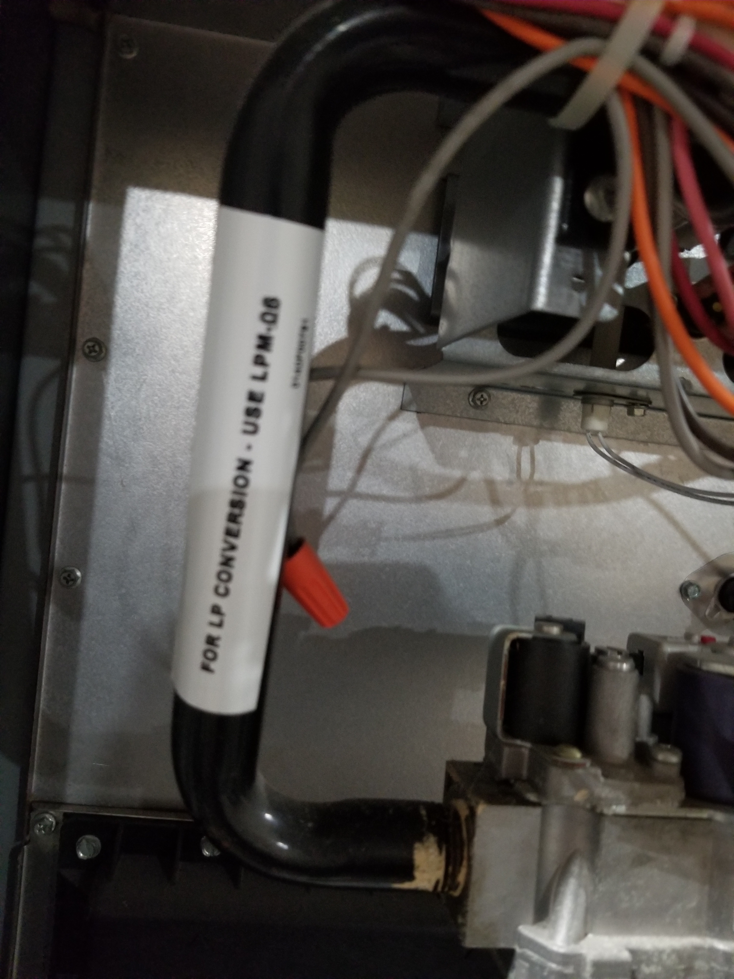

I had an inspection yesterday where the furnace had a LP conversion kit. The house was on natural gas and not LP though. Will this negatively affect the furnace?
That doesn’t say it has a conversion kit. It only says what conversion is to be used.
Thanks for clarifying that, Chuck. I misunderstood. I thought that meant there was a conversion kit installed. Thanks.
Exactly, what Chuck said. :smile:
Ditto Steven, take it from an HVAC technician of 40 years. However, I make it a habit to (of course) run the heat to make sure it operates smoothly. Good luck.
