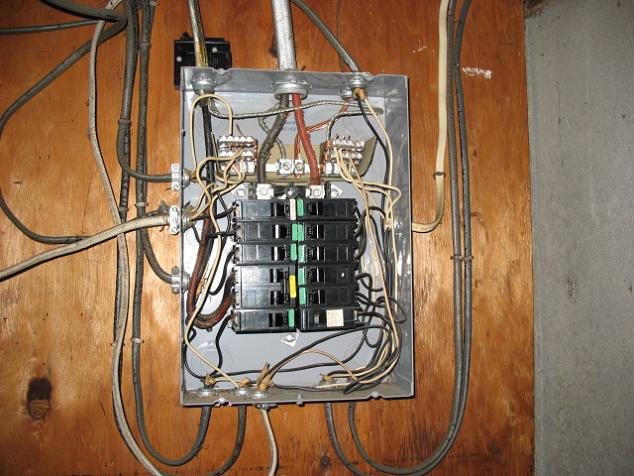

The meter is on the outside of the home, no disconnect noted, inside the basement is the panel directly below the outside meter with main coming through the siding right to the panel. No main breaker in the panel.
That panel has more than 10% of its overcurrent devices protected at 30 amps or less that also has a grounded (neutral) so no matter if there is no more than six disconnects or not it is required to have no fewer than two mains.

The SE Cables sheath does not extend into the enclosure, Also it is clear to see that a main breaker is needed…while it is entirely possible for the 6 disconnect rule to apply with this enclosure…it does not in this shown setup and would indeed require the main.
Also it appears the majority of cables are not supported properly…simply defer for evaluation from an electrical contractor.
Where it is evident that a main is necessary…we would defer for repair or replacement, and additional evaluation by a qualified electrical contractor. A qualified electrical contractor who, in this case, would argue against the need for a main would be in error. Correct? Especially considering the possibility that it was a qualified electrical contractor who installed this service panel to begin with.
YES! I counted 11 overcurrent protective devices in this panelboard. I also see where the existing cables appear to be without an equipment grounding conductor since they are the old 2 wire types, and if they did have the EGC may have been the earlier types with one size smaller. The gas pipe, although there for many years would present a question in an installation today, because the space above that equipment is restricted to electrical materials, etc.
Any panel including one that has only six single pole breakers that has more than 10% of its breakers 30 amps or less and also utilizes the grounded (neutral) conductor is required to have a main. This is covered in 408.36 of the NEC and has been in place for many years.

Jim, From looking at the many installation errors in this photo and hearing from our learned colleagues it appears that we should consider the possibility that this is a D.I.Y.

Everything I saw was telling me things were non-professional but seemed to be OK:roll: but my gut was telling me I better do a little deeper digging. I was especially concerned when I didn’t see a main breaker as I was under the impression that all main panels needed a main breaker.
I am not a lic. Electrician and I certainly do not have the answers but do try to get things right.
