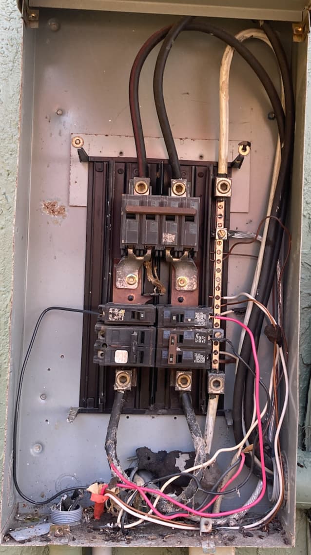

The picture of the main panel is from a house I am currently inspecting. Besides the bare wire, insect nest, cobwebs and debris, can I get an expert opinion on the wiring, breakers (or lack there of) and anything else useful? Thanks

What is the bare wire issue? The biggest problem I see, besides the corrosion and debris, is the use of NM cables in the raceways exiting the bottom of the panel. NM cables cannot be used in a wet location and the inside of a raceway outdoors is a wet location. There are other issues tell us what you see.
The NM cable you reference looks to have powered a low voltage light system for a dock at this lake house. It is fed down through the panel box into a PVC pipe that runs the length of the house to a low voltage regulator. Other than that, the picture tells the rest of the story. Thank you all for the feedback. Very helpful!
So what other issues did you find? Just a thing you might want to keep in mind that “low voltage regulator” for the lighting is actually called a transformer or power supply.
