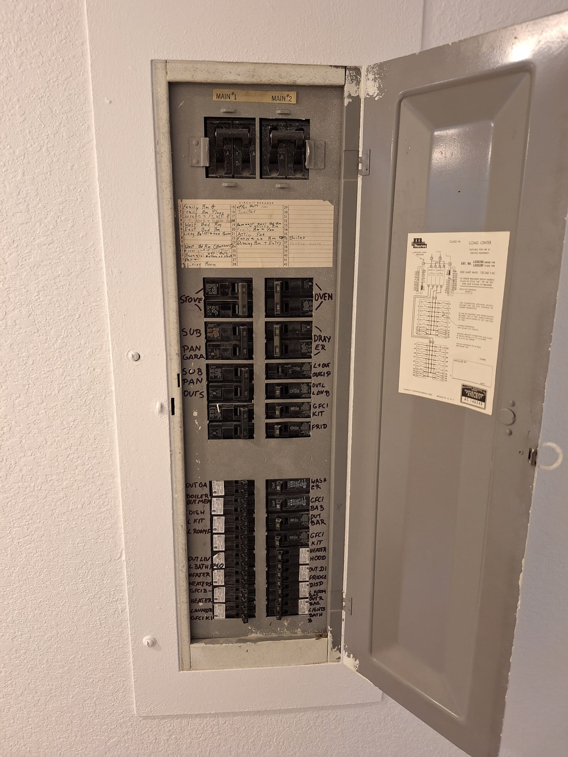

Main panel with 2 main disconnects?
Was wondering if anyone’s ever seen a panel like this before and if anyone has any general knowledge about it? I’ve yet to see a panel like this.
Split-bus… Main #1 for bottom half, Main #2 for upper half.
Its a single cabinet with two 100 amp service disconnects. Other than that it’s not much different than a single 200 amp panel. This differs slightly from a split bus panel because a split bus panel had no means to disconnect the top section which had multiple OCPD’s.
Thus where the “6-throws” rule originated (I believe).
Could be or maybe they designed the panel around the 6 service disconnect rule. Either way those split bus panels are obsolete.
To clarify because I had this conversation yesterday…split bus panels are obsolete, but not illegal and they don’t have to be replaced…or am I missing something?
You’re correct they do not require replacement simply because they’re the split bus type. Since split-bus panels are likley decades old they may be nearing the end of their useful life but that has nothing to do with the obsolete design.
This also came up in my conversation yesterday. We’ve all read the commentary online about the useful life of panels being 20-40 years. But any actual research that I’ve seen supporting that contention is thin to just guessing. What puts a 41-year-old Square D panel at the end of its useful life? I see and I bet everyone else here sees very old panels that show no evidence of age-related failure or defects. Until someone shows me evidence to the contrary, I don’t call-out age of electrical equipment as a defect.
