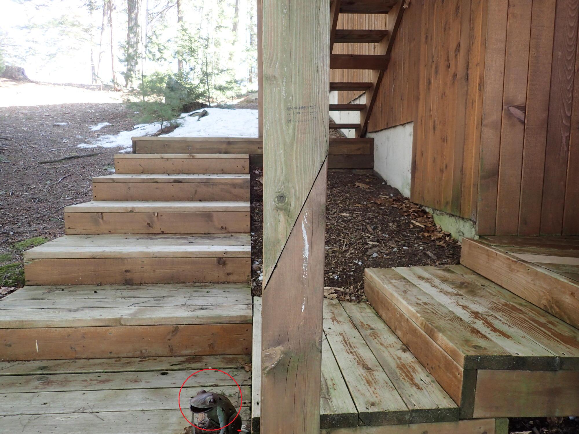

Main support post for deck
Main support post for deck :shock: from today’s inspection. Five nails per side hold it together. I have to assume it is a recent repair.
Hell of a scarf :mrgreen:
Accident waiting to happen.
Agreed, very nice scarf joint and really stupid use of it!
Danger Will Robinson! :shock:
Omg. Wtf.
Wasn’t me, I didn’t do it. :mrgreen:
