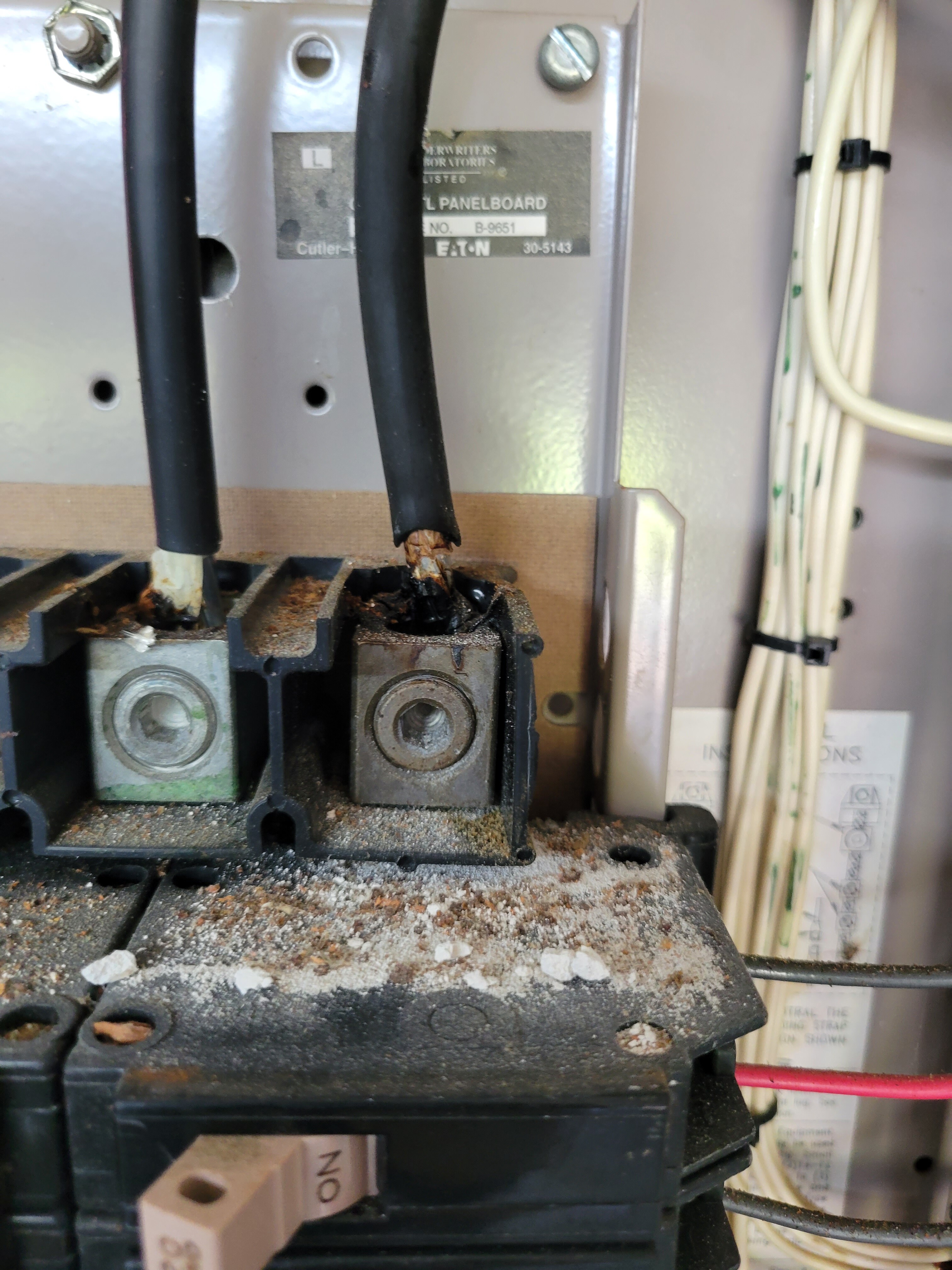

The infamous Material Defect Vs Major Defect Question…
Electrical Panel shows signs of overheating at lugs.
Wires directly above panel in attic access discolored, bathroom vent shows signs of heat damage directly above wires, electrical tape melted on service feed…
But no smell of recent melting action, no distinguishable heat signature using back of hand technique.
Major or Material Defect?

Neither… I’m not a sparky and qualified to make such a determination based on general observations.
Just report your observations and recommend further evaluation. If you don’t and it burns down…
Get that thought/phrase out of your mind, and your reports.
What you’re showing is definitely a problem that needs to be addressed.

Nathan, report what you see and refer it out to a qualified electrician for correction…simple.
Thank you for all of the advice! Though using Spectora it is hard to avoid the Minor, Major, and Material defect classifications… but I definitely get that a defect is a defect. See it, Report it, Recommend it get fixed. Move on.

State what I see; explain the consequences for NOT correcting it; then recommend repair by a competent %$#@*&^%$ … AND keep moving
I would use wording that includes that this is a Safety and Fire Hazard and refer it to an electrician for immediate repair. It’s significant and the client needs to understand that.

As for the original post, would definitely get a red category, serious concern and advise an electrician review, And in the report the customer sees this is what it would look like . When they click the pic it expands to full page
You may all disagree etc etc, but I think that is an excellent presentation of a serious defect
