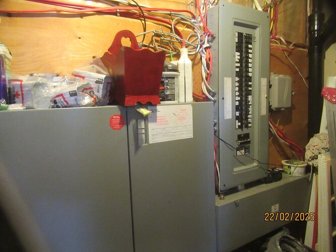

Why are there two sets of service conductors and where do they go? Is that a two-family building? Do the conductors pass through the wall and terminate in two separate meter sockets on the inside wall? I normally expect to see one set of service conductors and a dual meter housing in twin-plexes and duplexes. I don’t think I have ever seen a setup like this.
Marcel,
Any idea what was on the inside? It looks like parallel service raceways to a CT cabinet on the inside. I see the small meter which may indicate a CT metered service.
That sounds about right Robert!
4,000+ sq. ft. single family house with electric heating and 400 amp service disconnect as per label on cabinet and a CT. I could not confirm as the cabinets were sealed by the utility. There was a 200 amp distribution panel which was full; owner commented that they were planning on adding another 200 amp distribution panel for a planned hobby farm barn.
