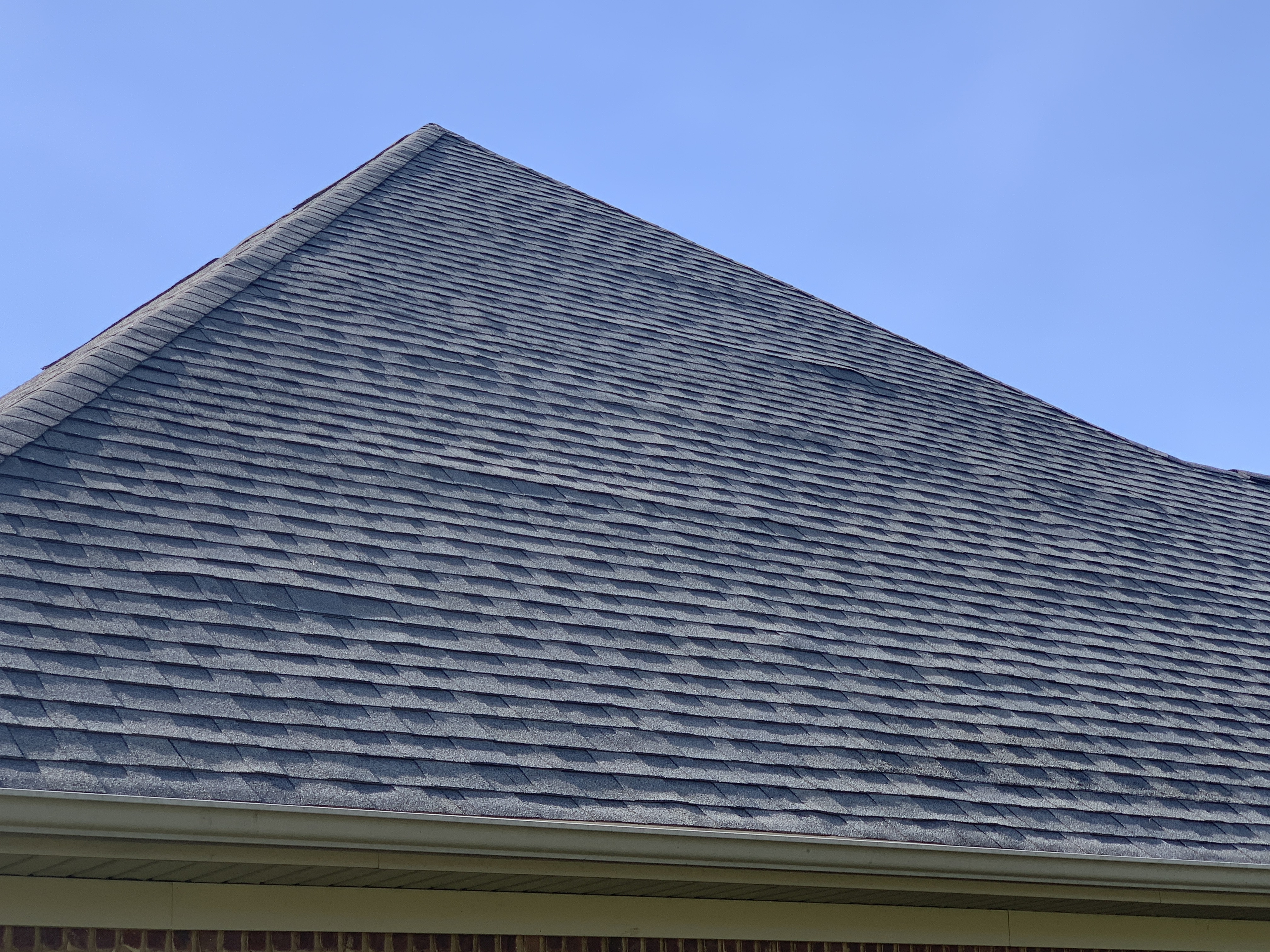

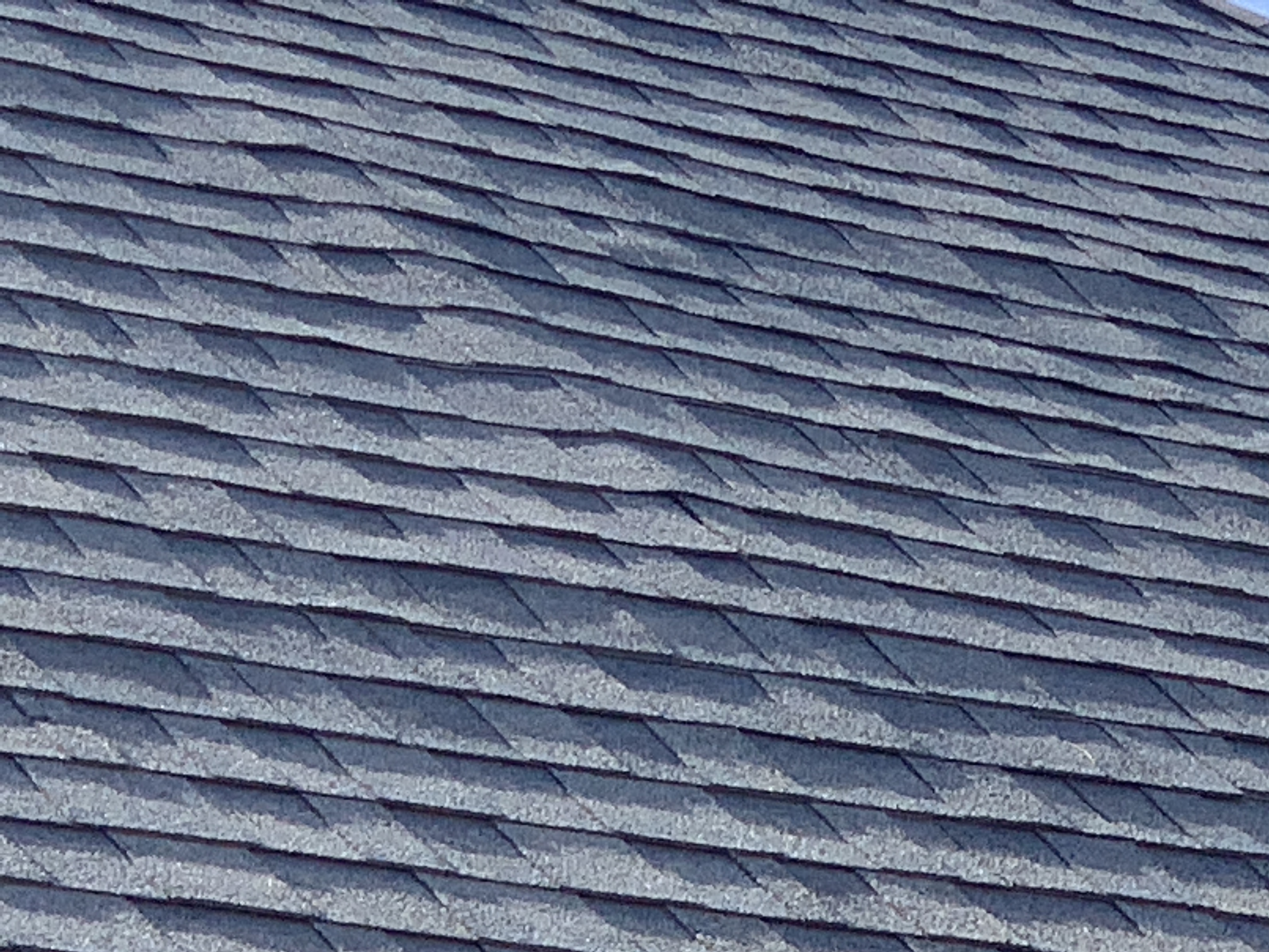

I had a house today with metal framing. I was not impressed. Sheathing was coming loose all over the place, which was also seen outside where the shingles were buckling in straight lines 4 ft up and down or 8 ft across where edges of sheathing were lifting up.
In the attic I observed that the roofers had used their standard nails to attach plywood sheathing to the metal framework. It is my understanding that only screw should be used with metal framing. But I have not built with metal before. My research on google did not turn up much.
Anyone here have experience using metal instead of wood for attic structure?

From what I could find online, only screws are to be used with steel framing, not nails, which seems like common sense to me.
It looks to me like this roof was installed on a monday following a NASCAR weekend.
Looks like they missed the framing with the screws.

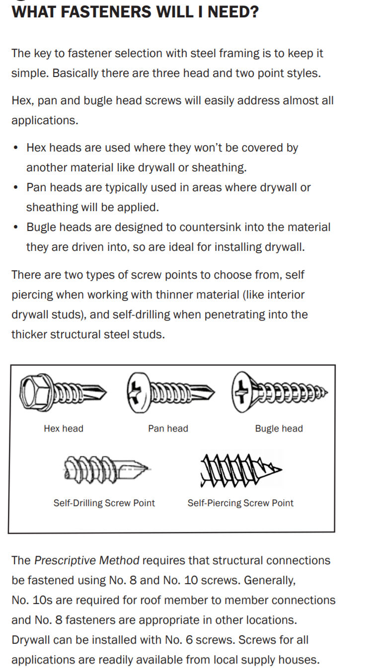

Here is a link for future reference if you need it.
And for attaching plywood to metal studs we always used these wafer head tek screws.

For sure, and the sheathing doesn’t align over the C channel

Yes, screws are to be used because there is not enough material around a nail when nailed into thin sheet of metal to provide enough pull out strength especially long-term as things move and the holes around the nail get looser.
If that was down here a CAT1 hurricane would eat the structure.
Marcel, the actually used nails, not screws. Nails in a dozen sheets of sheathing are already pulling out and pushing up on shingles. Crazy. They needed a screw gun like you had.
They make a special nail for installing plywood to metal studs with these guns. I’ve used them in the past and they don’t pull out.
At the very least, they could of at least center the plywood joints on the framing and used those wafer head tek screws. Hard to tell what they used, but obviously needs repair by the appropriate tradesman.

Just looking at that picture, I would say it is the wrong gauge framing also.
Here is a view of the exterior if the roof. You can see where sheathing is lifting

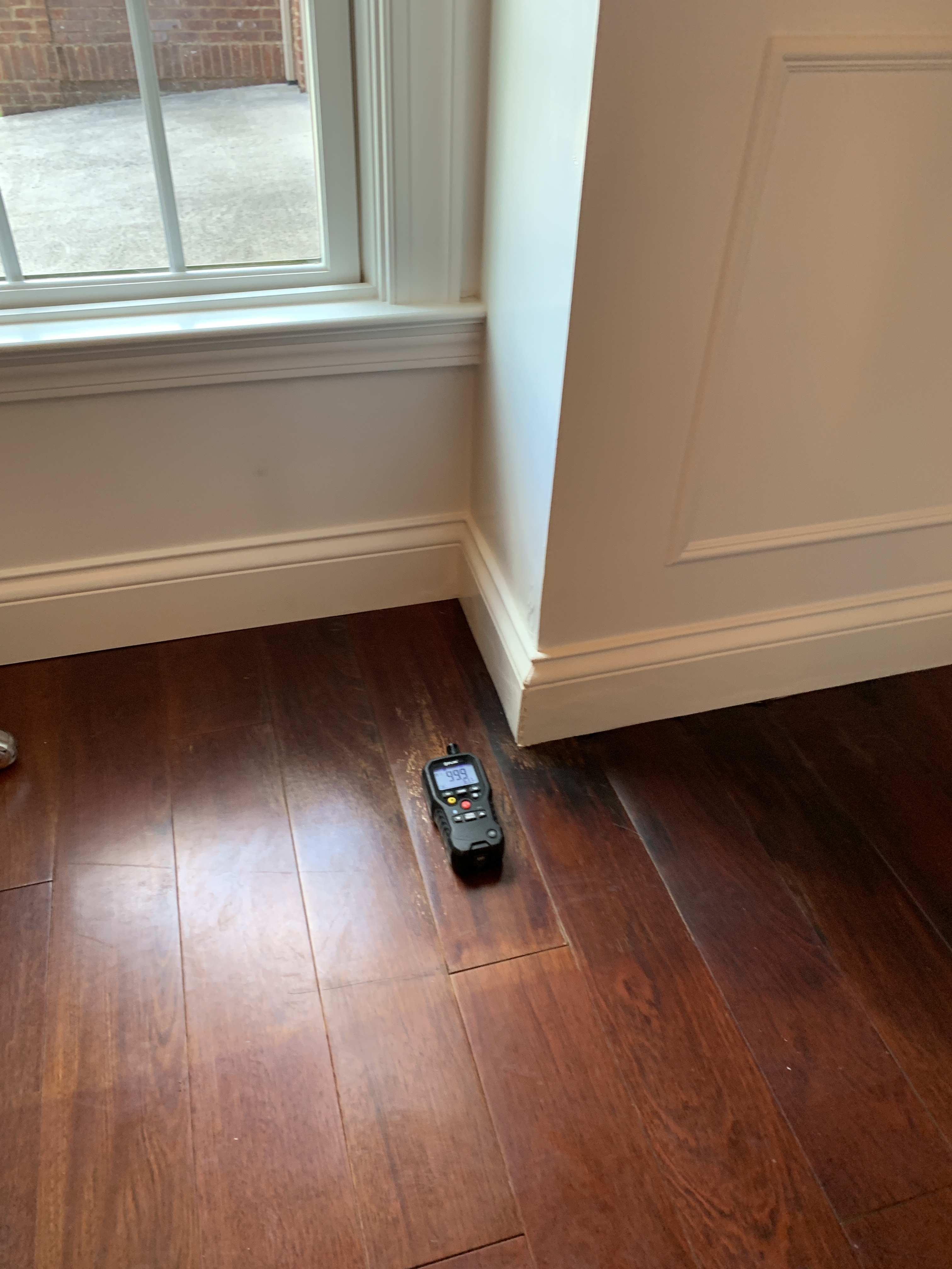

The roof leak into the front wall going all the way down to the hardwood floor in the dining room was the big issue.
