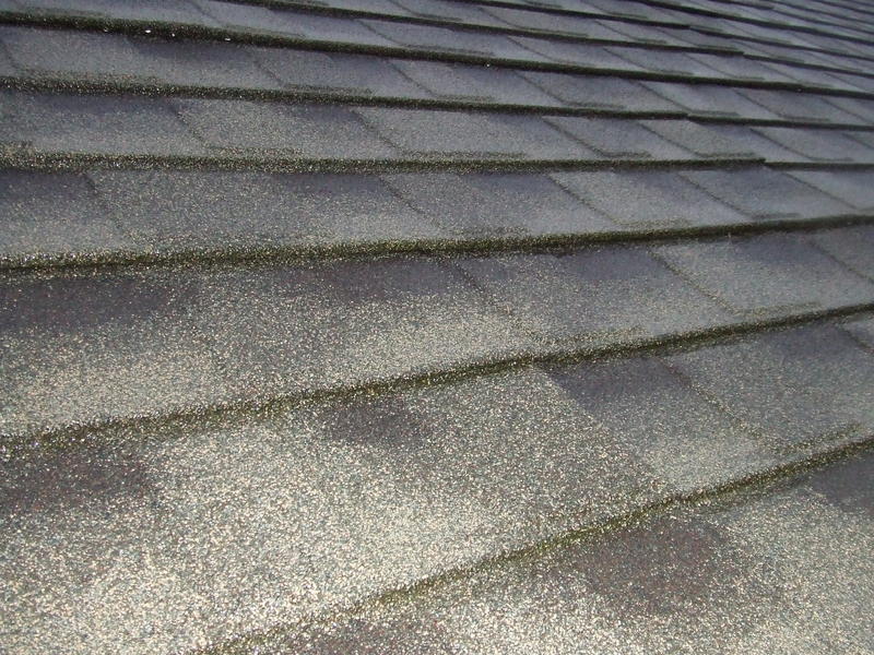

Has anyone ever encountered this type of roofing?
Metal roofing that installs similar to siding. Pieces are about the same size and configuration…
I found it…
http://www.metalroofingsource.com/stone_coated_shingles.htm

I think the product is called DECRA. shingle profile.
Pretty common in my neck of the woods. It’s a good quality roof covering.

I come across all types of metal roofing (steel, copper, tinned copper, etc…)
First time I have seen DECRA on a residential Roof.

Did you look at the vertical sidewall.
Suspect: Deficient side wall flashing lap. Open and exposed to weather infiltration.
Also the metal tile that is next to that open flashing looks deficient. Zoomed in but pixelation is distorting the image.
I see a few here and most are poorly Installed they should have avalanche guards as they are prone to lose the snow in one fell swoop .

Unless it’s on a steep pitch… where snow load is an issue it’s not as good as a nice, slippery smooth, standing seam, as stone coating holds the snow.
Decra is OK as Nick has pointed out. The stuff that is on Burger King is not the same. If it is shinny it can even be the synthetic or plastic ones.

The one big issue is cost. Reclaimed Copper is $6 dollars a pound in Montreal Quebec.
Standing seam is relatively more expensive than DECRA and the avalanche guards are hand made in tin shops.
No comparison on looks.
It lasts 50 years. When maintained it can go 100 years.

Cost about 3 times a regular roof .
Most people in Canada live in the home for 8 years .
A home with steel roofs do not sell for any more money.
Most are no installed correctly .
I would not pay the extra for a steel roof .
Save your money .

We had it put on the Church a couple years ago looks good and is big $$$
just gotta worry about the flashing details and the installers!
