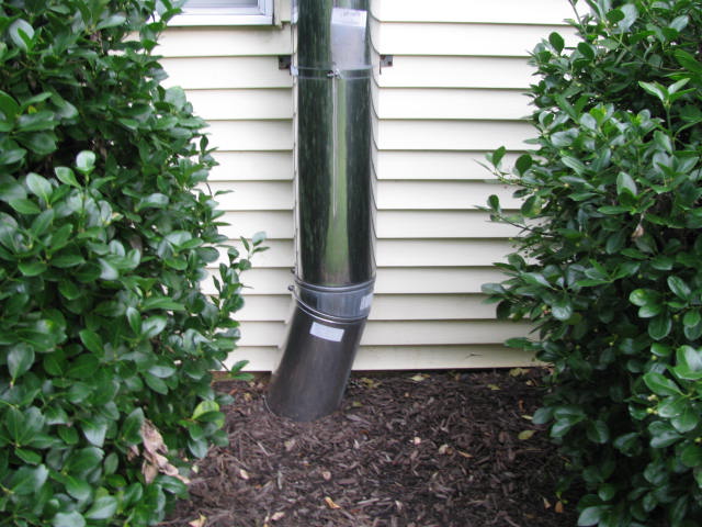

Inspection this morning. A wood stove located basement is connected to Selkirk stainless steel metalbestos flue pipe. The flue penetrates the block foundation wall BELOW GRADE and runs vertically about 2 feet before emerging from the ground. It then runs vertically at the side of the home with normal above roof termination. Does anyone here know of flue standards that apply to this unusual installation? Moisture, corrosion, leakage, etc are some of the potential issues.
Well to start with it is suposed have 2 inches from combustibles MULCH is wood . I would call a supplier and ask about being buried It is probably not designed or made for that. Just when you think you seen it all , Then poof another one pops up .

What i am wondering if there is covering flue pipe being buried Marcel, No way of checking when it rust out. Then there would be a problem with carbon monoxide .
This should interesting in the different views .
Wayne, I would have a hard time to believe that this installation is right.
Someone would have to work hard to convince me also.
It is just plain wrong, and don’t care if it is made of stainless steel, but the joints are not waterproof, they are water resistant to proper above ground installation. :)
Marcel,
Thanks for the information. I had to release the report before your post, but I did refer the flue installation to a qualified stove or chimney installation company. I know there is a good chance that corrosion and/or leakage has occurred in the buried section. The original installation was at least 11 years ago according to the owner. Must have been an amateur installation.
