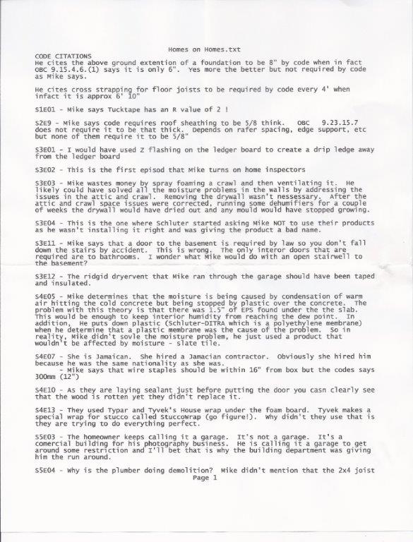

Understood. It seems very easy to say that someone is always wrong, but not so easy to illustrate exactly what was violated.
A deck is a very small structure and does not have many main components, so it would seem very easy to point out where these errors were made, or what codes were violated. Since this cannot be done, then one could reasonably assume all is OK with his decks, etc…
Yes it would also be very easy for you to do so to limit the chance of you not understanding the seriousness of pointing out what is wrong on the MB. It goes to safety, proper approved practice and many many other things that makes the show entertaining to the average Home Owner. However giving them the wrong info is not and will never be accepted.
Not so to real Contractors, Home Inspectors or Real Estate Agents that every day have to explain what the rules are.
When or where you built the deck also does as Greg has pointed out. Still does not make it right.
Disclaimer says None of the practices should be used for comprehensive advice.
So Greg, If you don’t need to use lag bolts what is allowed? If you don’t mind me asking.

[FONT=PalatinoLinotype][size=4]This was pulled from the National Building Code of Canada[/size][/FONT]
[size=4]I know and you know that bolting the deck to the home is better but no where in the code does it say to use bolts. According to an engineer I spoke with if you have four nails every 16" along the ledger it will exceed the 1.9 kPa that is required.[/size]
I never excepted nails to hold the ledger board in my reports .

Well I am glad he did not listen to that advice. Do you still require the proper spacing and proper graspable handrail or is that different also?
Whenever possible I recommend free standing deck design to keep from attaching to the home for obvious reasons.
Your comment on Codes shows me clearly why it is a minimum.
More on Mike ,I have these all on disk. Sorry this is the best I can do.

Well I guess there will be a lot more decks built as free standing.
Is an engineer required to design Part 9 structures? Does Mike use an engineer with the decks he builds? I’ve seen some where he stated he did.
How did he do this exactly with the decks he built? Please explain with reference to the OBC.
All of this looks great Roy, but hearsay doesn’t mean much. Are the comments made by an engineer? Can you specify. Thanks Roy.
What information is wrong with respect to the decks he has built? Does he not use an engineer who designs the deck? Is Mike not a real contractor?
Is the IRC used in Canada? Does it override the OBC? Are there any violations based on the OBC?
Perhaps bolting was to exceed the OBC. Can you verify with the engineer how 4 nails will exceed the 40 psf? How are they prevented to be pulled out? Would he stamp this design if this was used to capacity? Can you check with him since safety is a primary concern. Would he recommend this as a standard?
