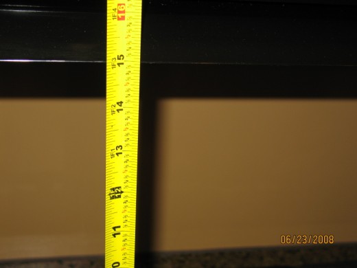

If I find clearance issues (IMO) above a stove (no tape measure involved), I simply “recommend improving clearances above stove”. If my client refuses to improve the clearances and there happens to be a fire, Look at my report…I told you so.
Here you go. Rangehood/microwave unit, 16" clearance, melted door gasket. :frowning:

This one on Monday was at 15"from the gas cook-top.
I can beat all you guys,… 13.5 inches from electric cook top to bottom of microwave. When does the madness end? :mrgreen:

My Rule of thumb… Bottom of Cabinet is usually 18" from countertop. Bottom of Microwave even with bottom of Cabinet. 16" minimum Clearance. Any lower, especially over a Gas Cook top, your heading towards big problems. Have Fire Extinguisher handy, preferably strapped to cabinet door next to microwave. :wink:
When I was installing cabinets, we would always have the cabinet above the range set at 31". It was so they could install a range hood or a microwave. When at a home, I check to see what the cabinet is and not the microwave. If it is 30" or higher I can be fairly confident that my clearances are acceptable. If it is less than 30", I will let the client know to check the manual for proper clearances.
Rules of thumb do not apply to listed appliances. The standard clearance requirement is 30 inches to combustibles. If there is a range hood or microwave (listed appliances), the clearance requirement will be in the installation instructions for the appliance.
If you need more clarification you can always call the manufacturer. The number should be on the installation instructions. Just calling something out because you think it is wrong is not the right way to go.
