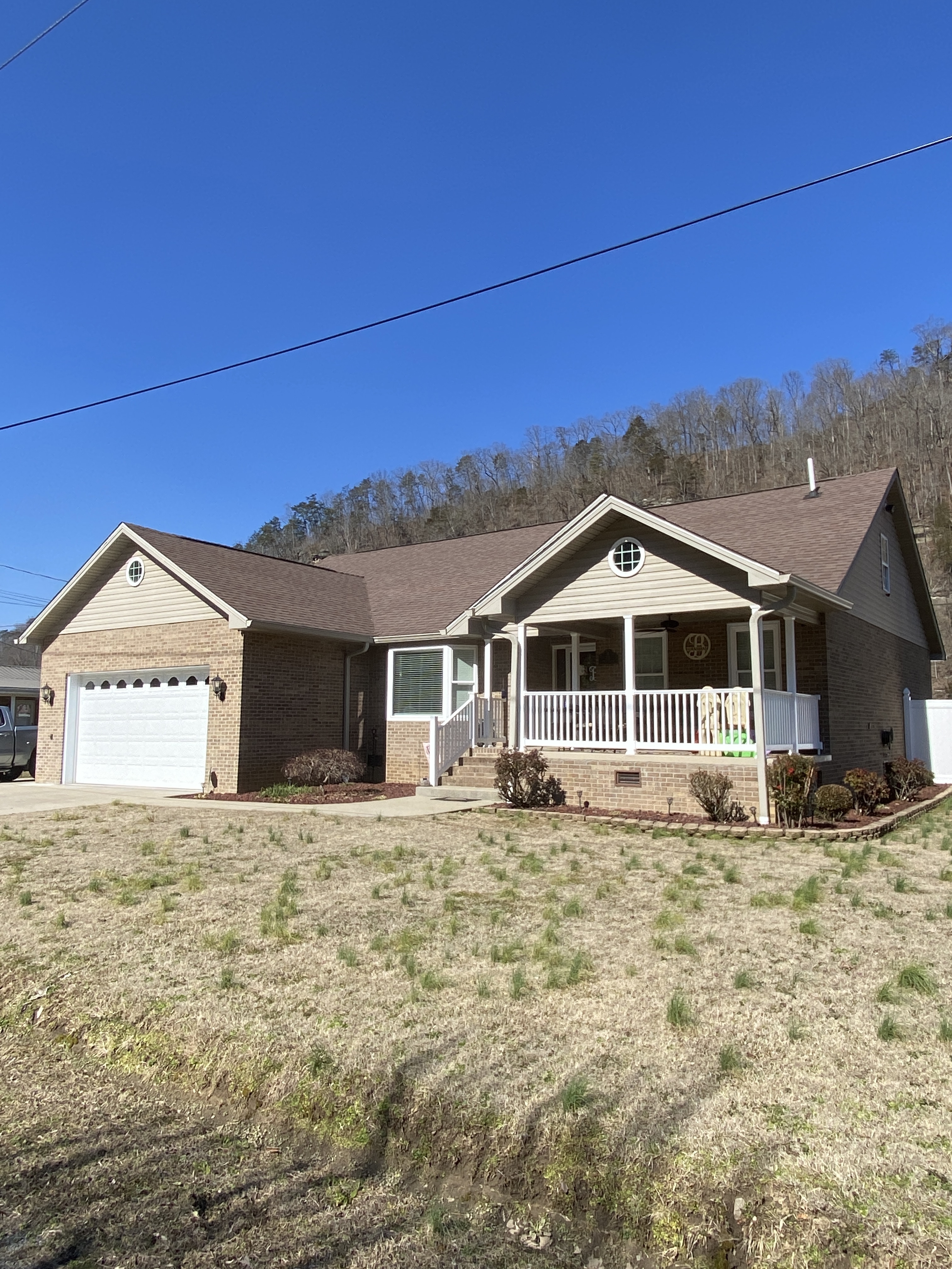

Missing sill plate?
There was no sill plate installed where the front slab porch is on this home. This was a separate boxed in crawlspace with joists and sheathing but no sill plate. The rest of the foundation did have a sill plate. What should I recommend here?
Alert them to the fact that the white wood joists will decay faster sitting on concrete CMUs rather than treated wood joists.
