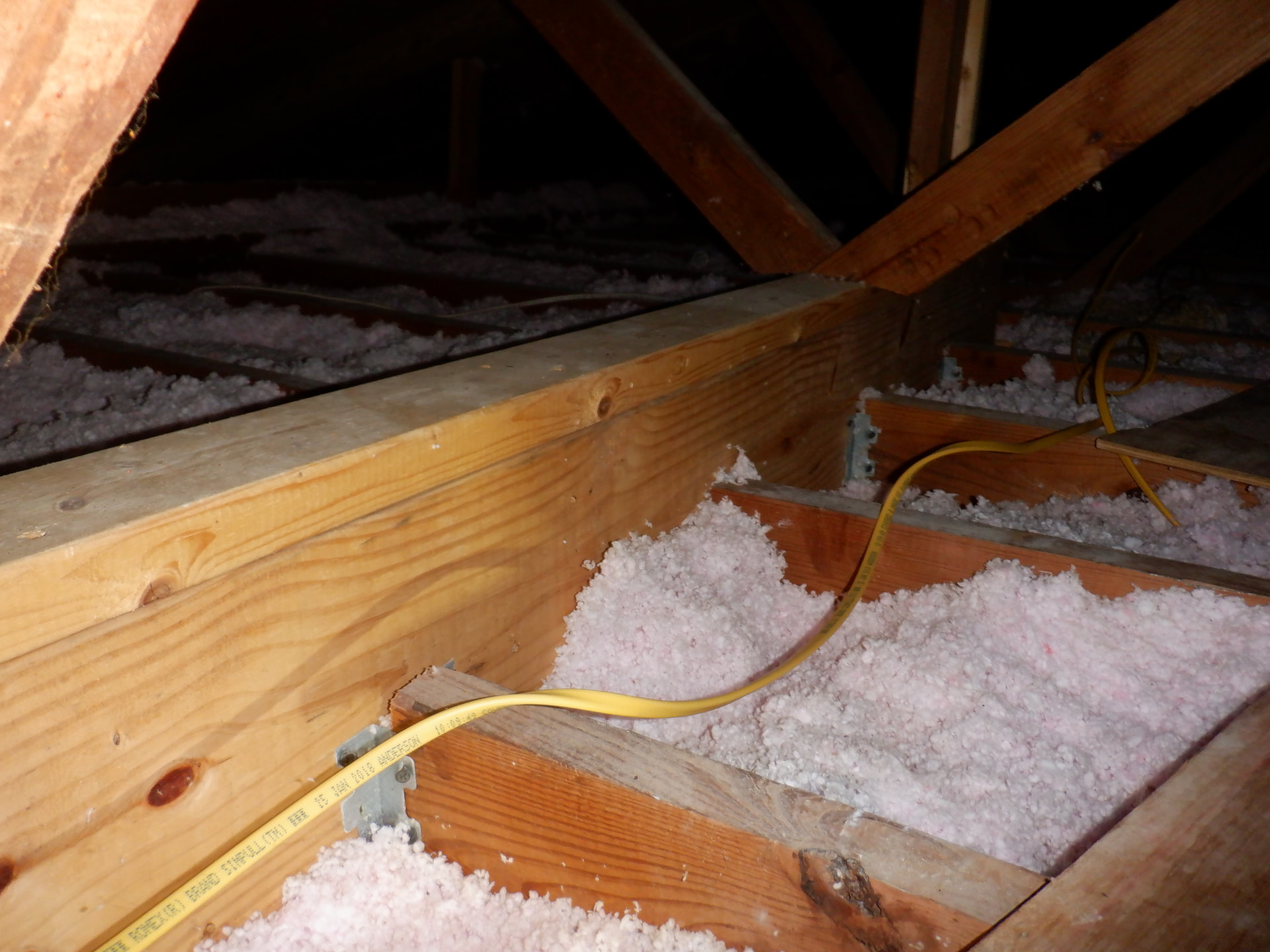

I need some help with a beam encounted in the attic of a renovation. I don’t have a carpentry background so I figured I’d call on some experts. This is from a 1961 1,226 sq ft home built over a masonry block full basement. The renovation reeked of DYI modifications that would make you shake your head and ask “what were they thinking?”.
The opening between the front living room and the rear kitchen/dining area was widened. They added a 12-foot long beam in the attic composed of 2- 2x10s with a piece of plywood sandwiched between them and a 2x4 running along the top. I’m under the impression from past forums that this type of construction is common.
My question is in regards to the rest of the construction. I’m not sure if the joist brackets are the right type and if they are properly fastened. It looks like they used sheet rock screws to secure the brackets.
I’m also not sure about the purlin support. How much of the support should be resting on the manufactured beam. Any advice would be greatly appreciated.

Sketchy at best.
I always say something like “non-original beam noted, recommend checking for permits. If NO PERMIT is found, recommend review by a structural engineer.”
Cause I know I am not an engineer, I’m not getting to load calculations.
I do know that everyone who’s ever watched too much HGTV thinks they can easily blow out a wall and throw up a beam and call it good. And I’ve seen plenty of shoddy work.
Of course, I don’t trust the permitting system either, but if it were done right, there should be a permit for it.
Simpson Strong Tie (and other brands) requires their hangers and brackets to be secured with approved hardware (correct sized nails or Simpson approved screws, they have a hex head). Drywall screws have a low shear strength and do not meet their requirements, therefore the hangers and joists are not properly installed. I would write this up as most likely not properly engineered or installed and recommend further evaluation by a structural engineer and/or licensed contractor.
The drywall screws are all you need to see there to call that out for evaluation and correction by a structural engineer.

Here’s my take, retired licensed building contractor now inspector:
Beam: Needs load engineering to determine if it’s properly sized. A licensed builder should know how to do that, a structural engineer will know.
Vertical and diagonal struts: They should be together to form a truss… Vertical is under extraction pressure and needs to be fastened as such. It is not. Diagonal struts are under compression. They bypass at the base and probably are only nailed. Nails will not resist compression. If this component was built as a truss, that would affect the size of the beam mentioned above.
Drywall screws are non-structural and inappropriate for hangers.
Other than the drywall screws, how long has this structure been around and is it functioning? I’d comment on that and whether or not failure was visible.
Of course, I’d recommend further evaluation by a licensed builder or structural engineer. My take…
Is a structural engineer going to grab a screw gun and “correct” the use of drywall screws, or are they going to just refer out a framing contractor to correct?
Personally, unless I observed a failure of some sort, I would have a framing contractor “evaluate and correct”. They certainly made it easy enough to swap out those screws with the lack of insulation.
There’s a fair chance that a framing contractor put in the drywall screws.
Only a thorough structural evaluation will determine if the beam is appropriate for the span. The screws can easily be replaced.
