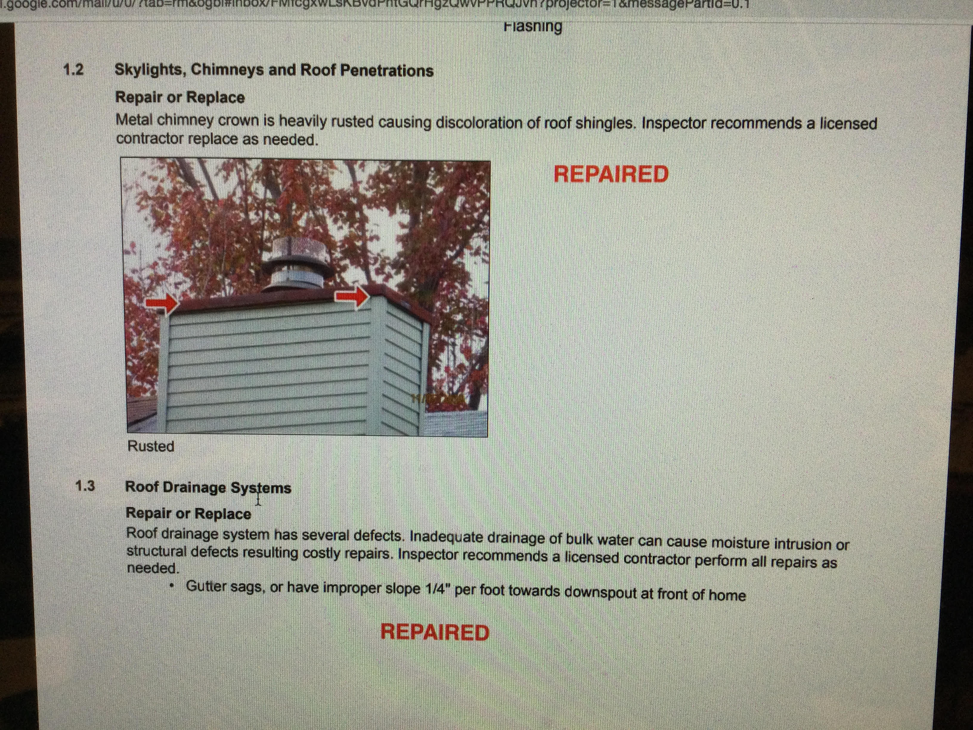

So I am doing an inspection this Friday for a client who has made an offer on a property. After making the offer, the LA provided the BA with a copy of an inspection report from Nov 2020, which was a decent report and found several important issues. The LA provided repair receipts for some of the defects found. I also received a copy from the BA. What I found most interesting and concerning is that the LA also modified the previous report with written comments like “REPAIRED” or “OPERATOR ERROR” or “NO RADON” before providing it to the BA. No pictures of the repairs, only receipts. Of course I’m going to do my own inspection on Friday regardless, but hasn’t this LA crossed a line by modifying the previous inspectors report? Should I inform the other inspector that his reports are being modified without his knowledge? Seems totally unethical to me. Thoughts?

The BA told me the LA made the modifications. It’s not hand written, it’s done in red typed text, appears to have been edited in PDF form.

Maybe post a picture or scan it so we can see the edits.

Here you go, screenshots:
I think the one that is most concerning is the sump pump one, because the LA/seller is trying to bypass the clear defect of the missing sump pump, etc. “Builder design - basement has never flooded.”
