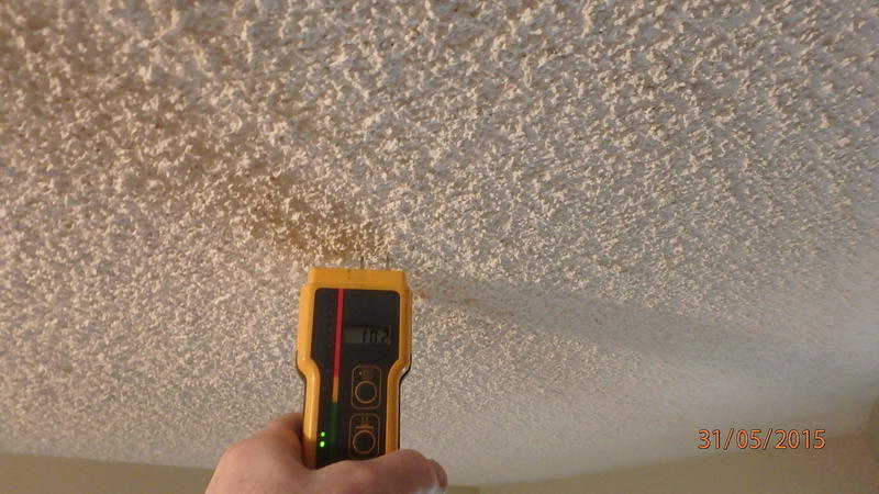

At today’s inspection there was a noticeable repair at ceiling main entrance area which was directly below second floor bathtub drain.
The repair area tested 10% moisture while the surrounding areas tested 0% so I reported that homeowner be questioned as to when repair was done and what was the repair. If repair was done a while back, then a qualified plumber should be contacted for repairs.
The exactly how I “test” for moisture, comparable samples at surrounding area. In your case I would definitely report what you detected.
Hate to disagree, but the standard is returning the affected building materials, that are not removed, to level 1 (previous condition before affected). You need to establish what that level 1 is, which can be in the range of 7% to 10% for drywall. I took the drying class too…IICRC-WRT certified.

Material can surely have levels of moisture in it…is 0 not considered dry?

How do you establish level 1 condition (who did you take your wrt cert with?) when you respond to a water damage and the materials are already wet? Did you have them somehow before you showed up to the property? You may be thinking Category, what category the damage was, which has nothing to do with your meter.
This is helpful…seriously! And your not all of the sudden? C’mon with this garbage.
No, not Category. That would be related to the type of water contamination and what protocols are to be used for each Category. Maybe “Level 1” is not the correct term, but the premise is correct.
Establishing Drying Goals
“Restorers should establish a dry standard and drying goal for affected structure, systems and
contents. Restorers should record and document moisture measurements. The dry standard is usually
determined by taking moisture content readings from known dry materials in an undamaged area or
structure, and using these readings to establish a drying goal (refer to Chapter 6 Psychrometry and the
Science of Drying). When it is not possible to locate unaffected materials within the structure, then an
available and comparable structure can be used to establish the dry standard. In the absence of a
comparable building, experience from previous drying projects can be used.”
IICRC S500
