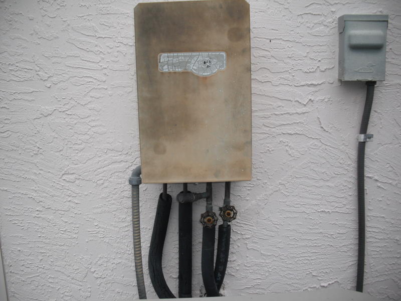

Moneybox-Water Heater to HVAC???
Does anyone have info on MONEYBOX unit that circulates from hot water tank to outdoor a/c condenser?
What would you like to know?
Heat recovery units, also known as desuperheaters, utilize the hot refrigerant from when your central air conditioner or heat pump is operating to heat water in a traditional tank water heater for domestic water. This helps lower the cost of your utility bills for hot water. It also extends the life of the air conditioner or heat pump since the refrigerant entering the compressor is cooler.
I dont have an specific information on that particular brand. I know that I have never seen one get hooked up after a condensing unit upgrade. only on the original unit installations.
I dont test them and make that clear in the reports. I only note if it is hooked up or abandoned.
Thanks Ken
I am trying to find some info on the web or something that shows in detail how it works.
Client is not familiar with them, neither am I.
I know it helps heat water and cool refrigerant, and thats about it.
Will it also help heat pump in cool weather ?

The ECU Hot Water Generator Exchanger
The ECU is connected to a water heater and an air conditioner, heat pump, or refrigeration compressor. A small pump circulates “cold” water from the bottom of the water heater tank through the heat exchanger within the ECU where it interacts with the hot refrigerant gas from the compressor via a heat exchanger.
The resulting heated domestic water is then pumped back to the water heater. Reclaiming waste heat from high compressor discharge temperatures is a proven principle of energy recycling that produces abundant hot water safely and economically.
A 125 degree hot gas cut-in thermostat insures the ECU only runs when waste heat is available from the refrigerant system, a necessity for heat pumps. The 140 degree hot water cut-out thermostat shuts the system down when the incoming water is 140 degrees, indicating a full tank of hot water. Other options include: /F - freeze thermostat that activates the water pump should temperatures in the ECU itself approach 32 degrees (freezing); /V - bleed type ball valves for draining the unit in the winter; /PC - hand valves with high pressure blow-off’s when needed for local code compliance; /R-410A - tested and approved for both R-410A and R-22.

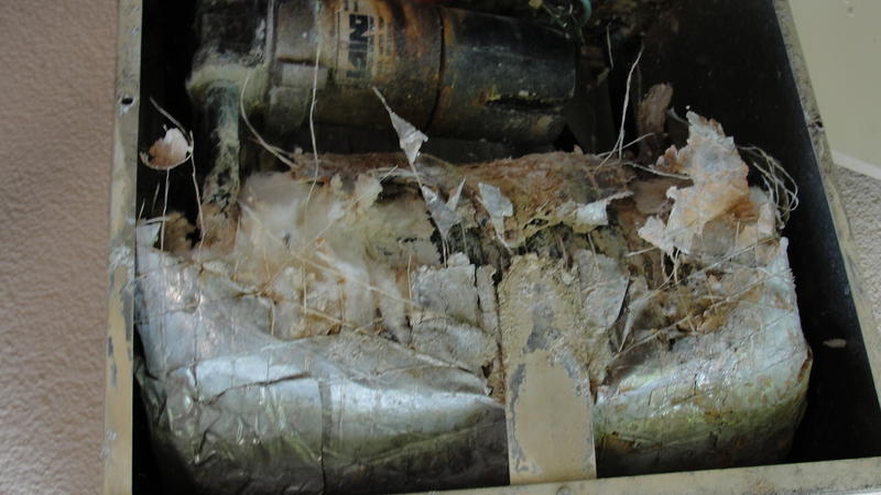

I cam across one the other day and the screws were out of it, so I took a look inside. Looks like a small circulatory pump and and a piece that is insulated, probably contains coils. oops the photo is upside downside
basicly 2 sets of coils on the condensor, 1 with refrigerant and 1 with water. When the condensor turns on a 1/16 hp pump shown in the pic above circulates water around the condensor heating the water making life easier for the W/H. They also use this method for heating homes when natural gas is used. Same application but 2 sets of coils in the air handler, 1 water and 1 refrigerant.
