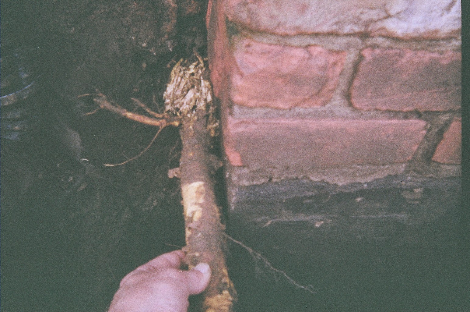

is that a snake bro? no dufus it’s a tree root

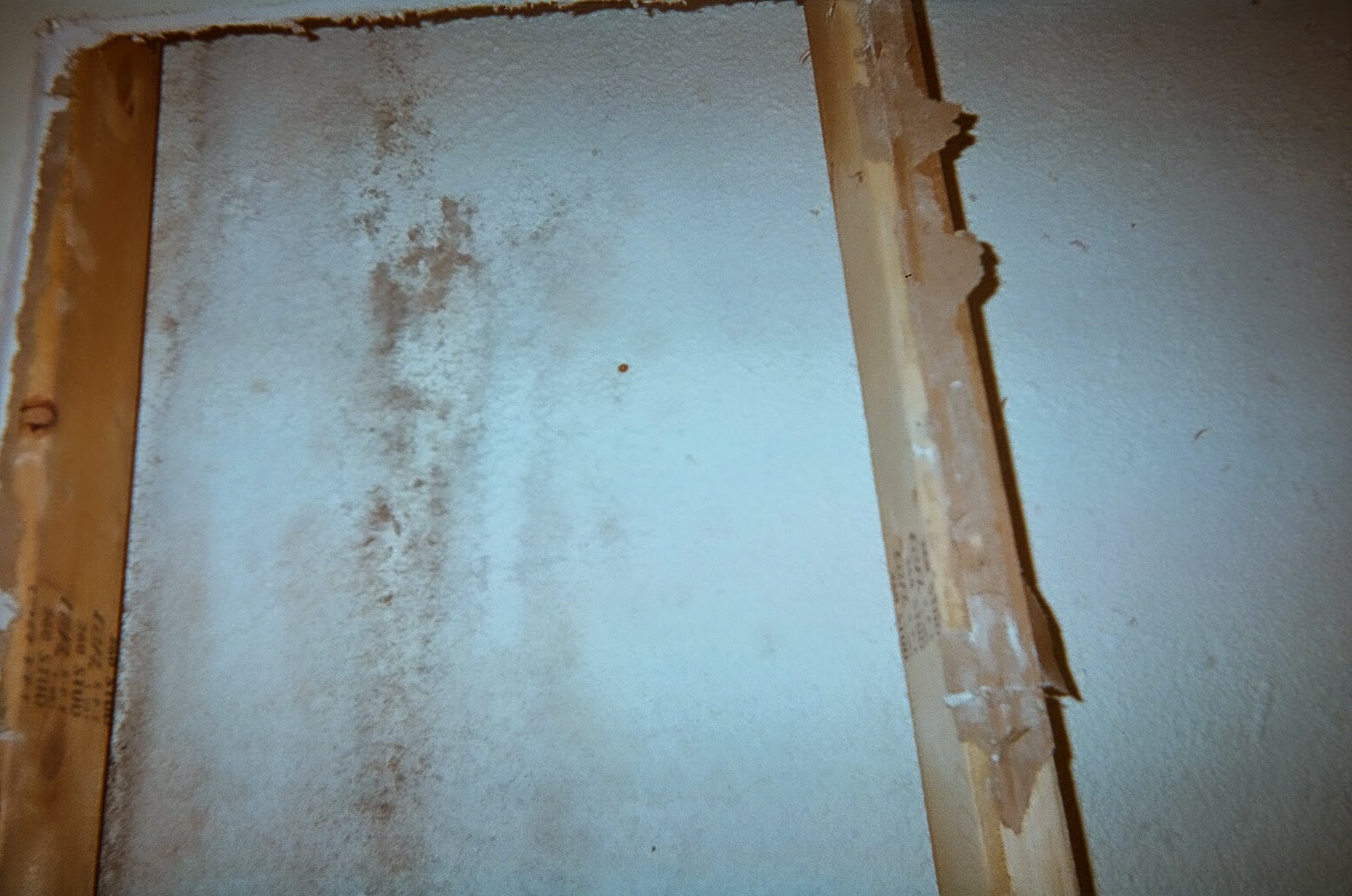

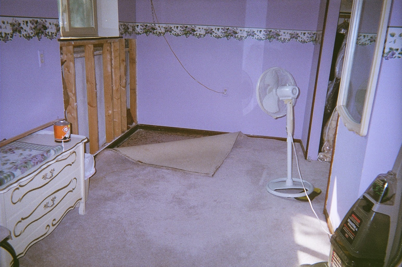

Troy, poured wall, crack previously injected!!! hahaha Can you say MOLD behind the drywall?

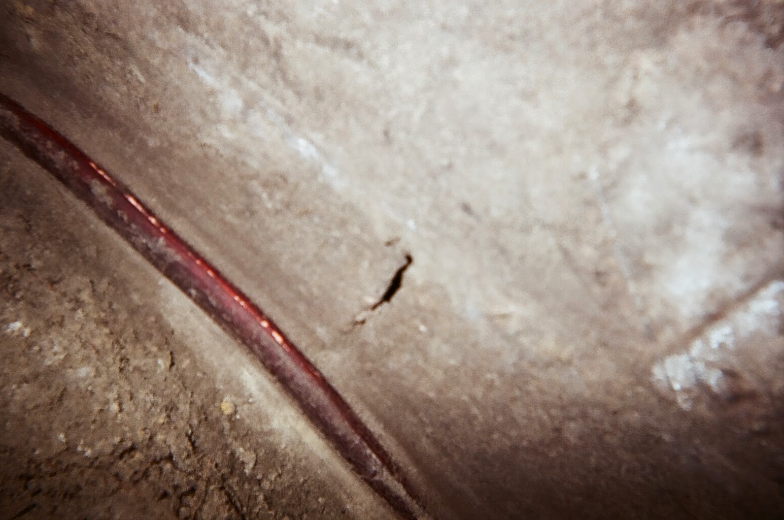

They claim, our epoxy etc goes all-the-way-through the crack to the outside? Does it? lolol
what is the black stuff? lol
did their CRAP go… all the way through to the outside? Nope. lol Why claim that it does when it doesn’t? Ohhhhhh, you will tell people whatever it takes to get a job, ohhhhh, now Bubba gets it

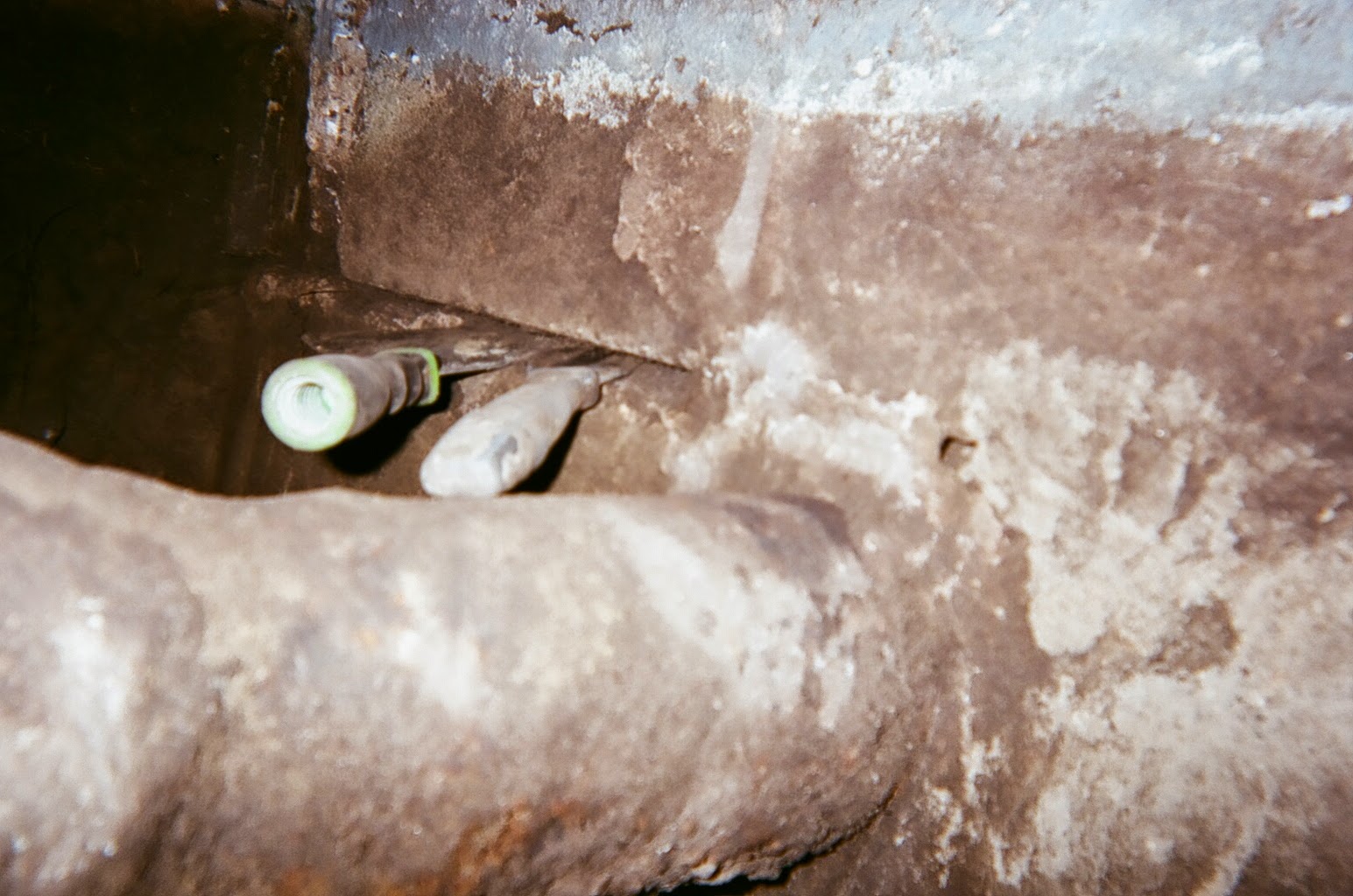

Rochester, poured wall, HAIRLINE CRACKS do allow water in basements, helllllo!!!
“monitor the crack”… lolol Hey Mr and Mrs BUYER, nah don’t worry about the LIL itty bitty hairline crack it won’t leak, maybe just monitor it and raise and slope the grade"… right? WRONG!!!
