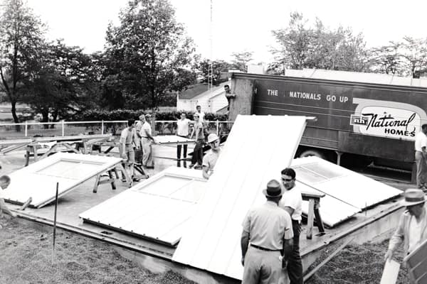

Maybe they had even more in store for 1955?

“Sturdy little homes, last forever”.
Thanks Bryce
Note this home is not built a conventional way. Adding outlets or replacing windows is… different.
