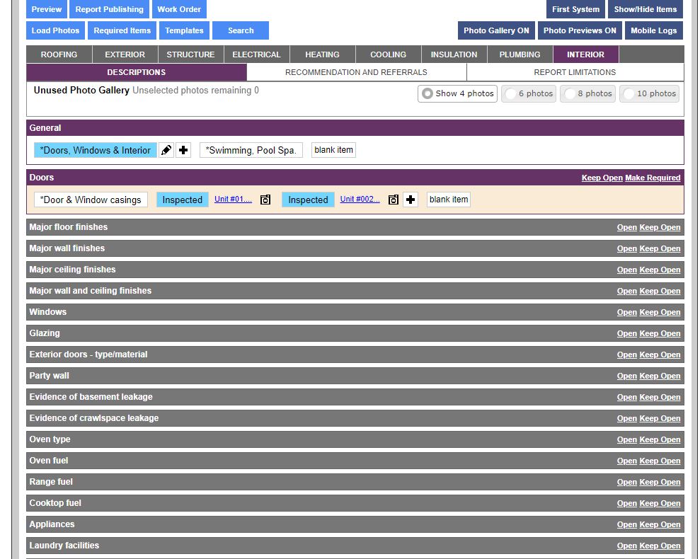

If there is 5 units …Do I do 5 individual Reports ?
If I do as one Report … I would like to see an example.

It depends on how you set up your inspection software, some use a rooms approach others use a systems method. Personally I always use a systems method, so what that means is that all electric defects are grouped together under one heading, then in the description the location of the defect is recorded. I find the flow of the report from a top down systems approach (as opposed to room listing) works best, especially in commercial jobs when the room designation is unmarked or it’s purpose is fuzzy.

Its quite simple to report multi unit investment property. I start by taking an image for the front door unit number/#. If none exists, use a piece of paper, mark the number with a pen, Number #1. Take a photo with the paper in-front of the door. Bob’s your uncle mate. Your in business.
Reports: Each defect is associated by the unit number.
Bathroom unit #5, unit 501 or A5, loose toilet, bathtub requires caulking, damaged bathroom tiles.
Unit #5, unit 501 or A5; Worn bedroom hardwood flooring.
Unit #1, unit 001 or A1: Loose baseboard heater cabinet, left/right bedroom. Unit #5, unit 501 or A5 Water Heater… Get the idea. Simple as that.

David, in your reporting software, for every defect location, Unit #1, Unit #2, Unit Number #3, open another associated window in the associate software component, IE: Interior; Doors, and repeat defects in the software. Repetitive association by/per unit number.
Look below. I repeated doors by associate unit numbers.
I have a simple repeat for water heaters. All in the same window. So simple to add information! Remember. It takes time buddy. More information = more clients.
Call me. I will try my best to explain it to you and give you a mock report to use as a template.
