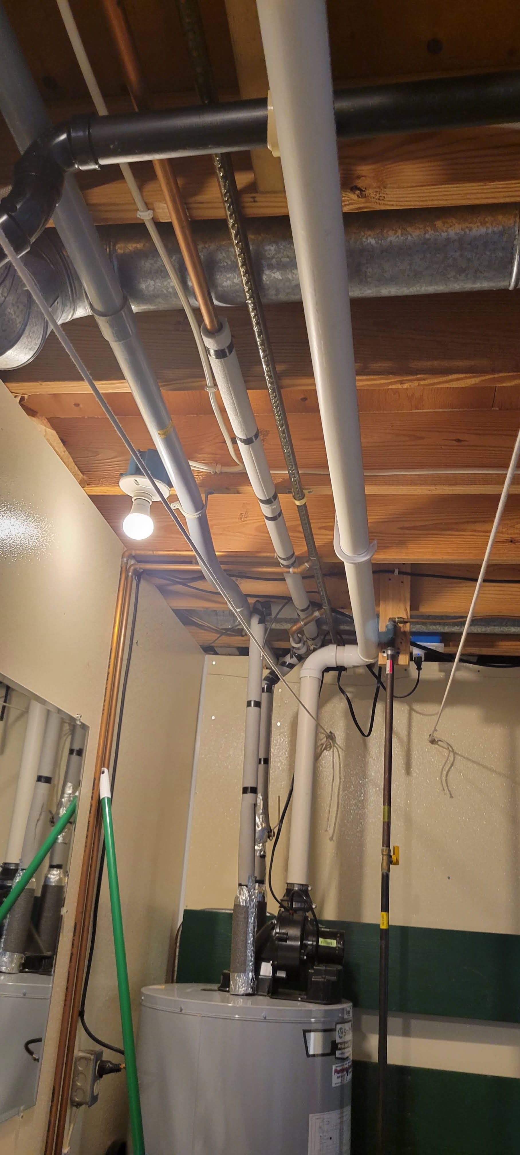

I did some math based upon some estimates for BTU/hr that are typical. The gas-fired water heater is about 40,000 BTU/hr, the furnace about 80,000 BTU/hr, and clothes dryer about 20,000 BTU/hr. So, combined (if all are running at the same time) that is about 140,000 BTU/hr. The confined space calculation is 140,000 x 50 cubic feet / 1,000 BTU/hr <= 7,000 cubic feet. Is your basement bigger or smaller than 20’x45’x8’ (=7,200 cubic ft)?
Does the interior door to your basement have vents (openings) in it?
What is the blower (motor) and additional sets of piping above the water heater in the picture? Is the water heater a “high-efficiency” model (looks like it)? Is the furnace also a high-efficiency model?

This is the dimensions of my laundry room, where these appliances are located:
Just the laundry room is 11x18.5x8=1628 cubic feet
The whole basement is 22x45x7=6930 cubic feet

This is indeed a complex situation which is hard to diagnose from afar. You have pointed at a number of potential issues, some could be related to the problems you are seeing, others not. Perhaps some explanations on how some of these systems are supposed to work might help give you some clues as to what is going wrong:
  • Your water heater is what we call a direct vent appliance, it draws combustion air directly from the exterior of the house through one (usually PVC) pipe and vents hot exhaust through another pipe back to the exterior. It should be a closed loop and not draw any air from inside the house and, therefore, should not cause any negative pressures as long as the air intake is air tight.
  • Your furnace is also a high-efficiency direct vent appliance. One (typically PVC) pipe drawing external air in for combustion and another (typically PVC) exhausting warm air out. It should also not contribute to any negative air pressures inside the house as long as the air intake is air tight.
  • Backdrafting is when combustion exhaust air is sucked out of the exhaust vent by negative pressures back inside the house, usually caused by another appliance or combination of appliances and/or a fireplace. Not only do you get more CO2, you can also get CO (carbon monoxide) inside the house that can kill you.
  • Both of those combustion air flows for the hot water heater and furnace are by induction blowers (fans), so it should be near impossible to backdraft those appliances if the induction blowers are working correctly. It is also likely that the furnace or hot water would shut down if it detects that the induction blower is not working.
  • You indicated that all of your inlets were on one side of the house and exhausts were on the other in your pictures. That is good. However, if the furnace exhaust indicated was actually an air inlet, that could account for how CO2 would increase inside the house (drawing exhaust air from another appliance back into the house). Another is if there was a leak in the exhaust pipe (or in any of your other gas-fired appliances). Both of those situations would also be dangerous for CO poisoning.
  • The CO2 levels in your house were not high and I presume you have CO detector that is working.
  • With most of your venting and ducting in the basement, the only ducts in your attic should be for the bathroom and kitchen exhaust fans. These should extend through your attic to the roof or exterior walls. Exhaust fans do cause negative pressures inside the house, but those are relatively small motors with low pressures and air flow (e.g. 50 to 100 CFM).
  • The ERV draws clean air from outside your house and exhausts stale air back out. It appears to be connected to your existing furnace plenums. It typically has two small blowers inside in the range of 200 to 300 CFM, but those should roughly be in balance and not contribute significantly to higher or lower pressures.
  • Your clothes dryer is also gas-fired with an induction blower. However, it probably gets its combustion air from the basement where it is located. So, it will cause negative pressures inside the house as well, but in the medium range (e.g. 100 to 240 CFM).
Based upon the above, if everything is working as it should, it is hard to see how cellulose from the attic could be getting sucked into the interior of the house. Something is not as it appears or there is something that is missing from our information.
