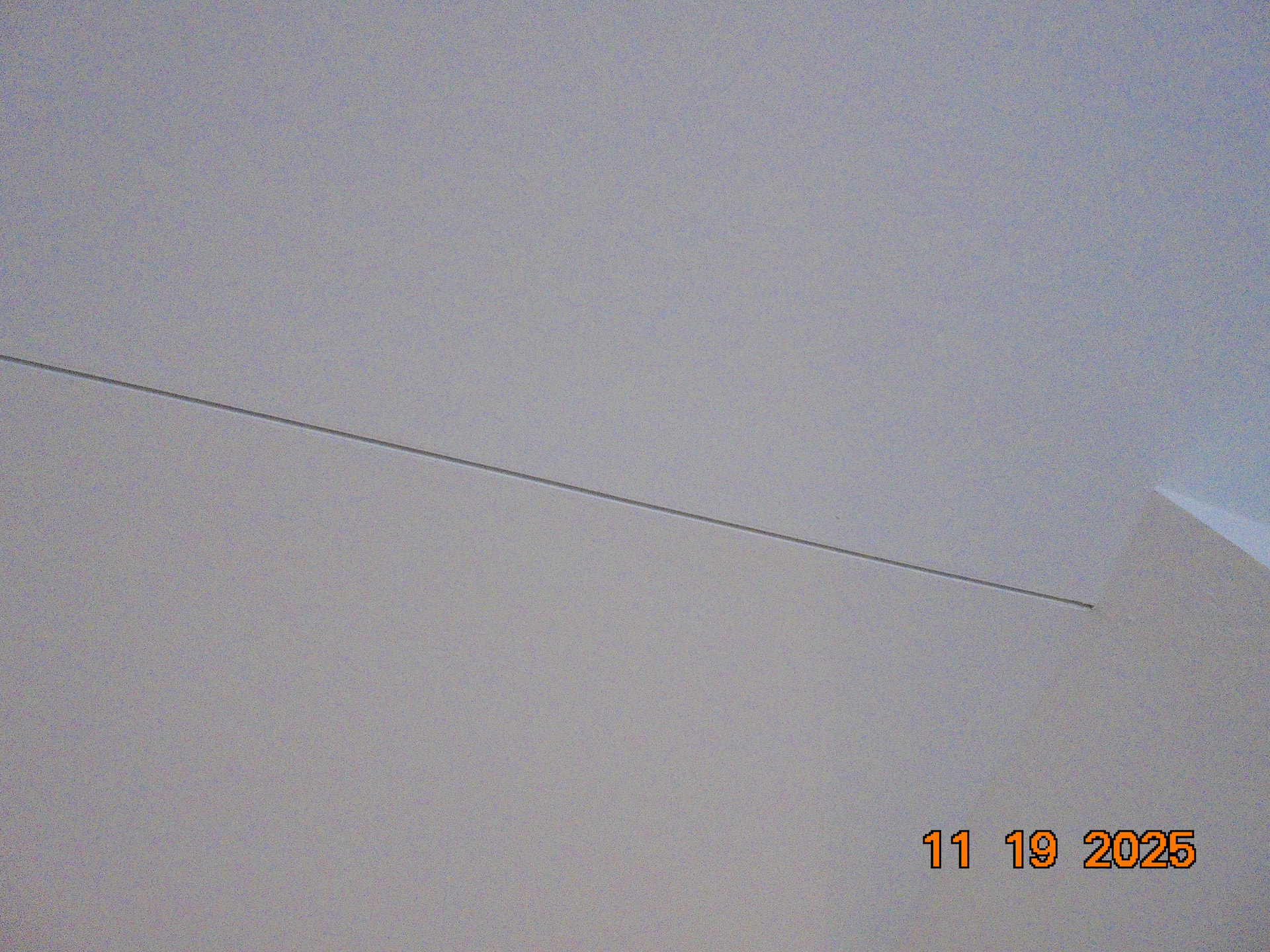

Never saw this on new built residential. Any help /ideas are appreciated about the way the ceiling is constructed.
Looks like a control joint.
yes looking at the link, it does. Just never saw these in a 2025 ceiling….
Yes indeed :backhand_index_pointing_up:
I concur.
Thank you for the link, Dominic
That is a common place to find a drywall joint crack…. Really a smart thing to do, adding in a control joint. I have never seen that in residential construction, but I have seen it in commercial builds.
Same here commercial only….Thanks everyone
Mark @mtimpani , which direction were the trusses running compared to the expansion joint?
parallel …..
