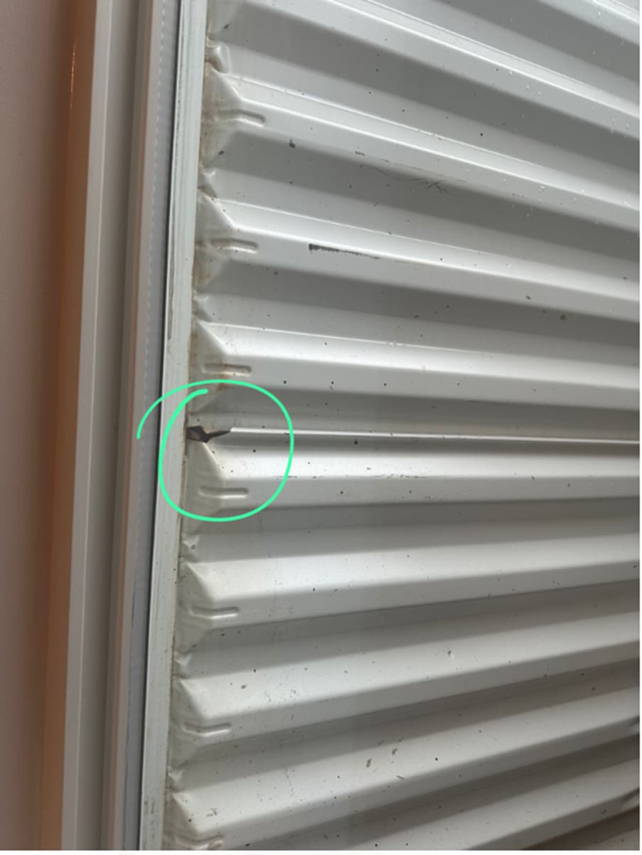

New builder saying this is okay
Is this really okay?
In my opinion this exposed sharp edge should be sanded and sealed on both sides. in the current situation it will allow water, air, and insect penetration. Builder response is that this is exterior and it is good.
Builder response is that we bolt it on the concrete and it is okay and passed county inspection.
Just report what you see and make a recommendation because of such and such reason.

Have a picture further away to see more?
It might be okay…not optimal but adequate.

In the first picture you posted, it looks like a window area well. Is that what we are looking at?

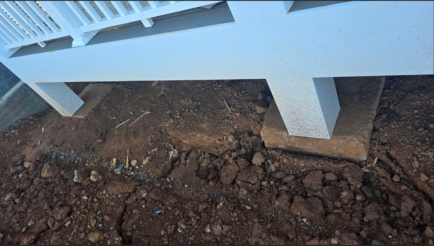

Now, as far as the deck post footings go,
–Where exactly are these “bolts” ?? Based on your picture alone, it appears that there are wooden posts sitting directly on the concrete.
–All builders will say “It passed the building inspection” as an excuse to avoid making repairs.
No. That would be just a feel good band aid repair. Footings, even for decks, need to be built to certain design criteria based on the load that is sitting on it and local building requirements… A local inspector would be able to tell you those requirements.

The first picture i posted is a basement egress window.
The deck posts on footings can be easily looked up online.
