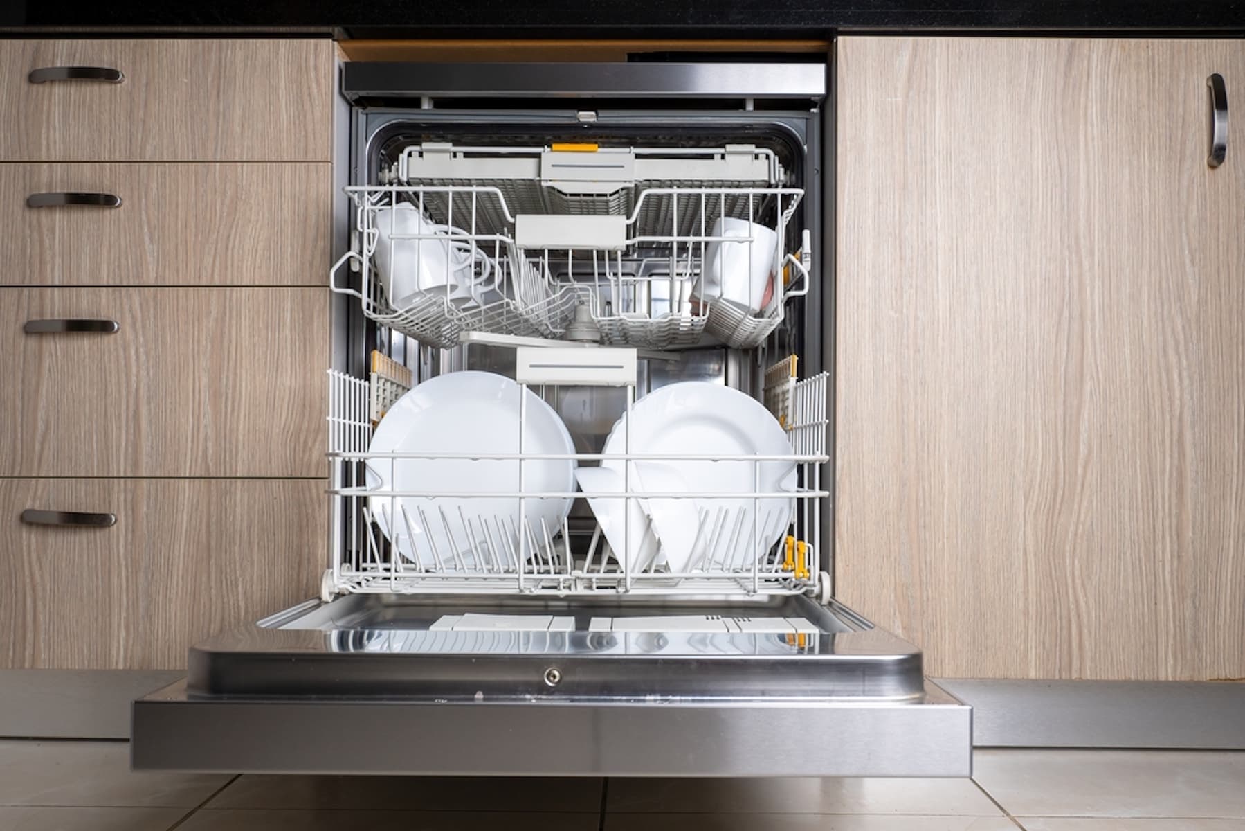

Here’s a new checklist for inspecting dishwashers during a home inspection.
For those inspectors who exceed the standards to provide a dishwasher inspection, here’s an inspection checklist for inspecting a dishwasher in the kitchen during a home inspection.
An addition is:
  1. Remove the kickplate and inspect under the dishwasher for installation and operation issues.
There are various issues that can be found there such as the following but not all inclusive.
  • Improper wiring to the dishwasher.
  • Signs of leakage and potential damage to cabinet bases.
  • Signs of mold growth due to prior leakage.
  • Loose or missing drain hose clamps.
  • Improper water line connections.
  • Damage to various visible components.
  • Leveling with pieces of debris instead of adjusting the leveling feet.
I’ve found all of these issues and more just by removing the kickplate. I find issues under close to if not 20% of dishwashers and that includes on brand new construction as well. BTW I mostly do new construction (99%) and if they can’t get it right there why should an Inspector expect it to be done right at an existing home?
