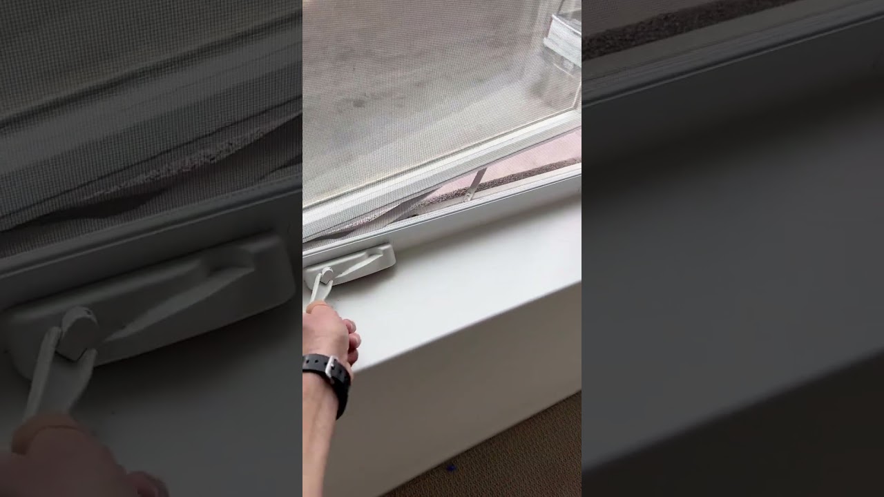

I inspected a second floor condo unit in a 2024 build today, new construction.
The bedroom window crank handles would only open the window a few inches in both bedrooms. There was a lever mechanism that appeared to keep the windows from opening further. I thought maybe there is a release to disengage the lever. But, the screens would have to be removed to access this lever. To remove the window screens, there were 4 spring loaded pins, 2 on top and 2 on the bottom…we’ve all seen these before. The two on top are around 7’ to 7 1/2’ from the floor. If I wanted to pull the top pins, it would have been a stretch for me and I’m 5’9. Anyone shorter would need a step stool or ladder, ie. special equipment, tools, or knowledge.
My report is already including an egress safety hazard because of my observations but I’d love some feedback and/or opinions / new con experiences on whether I’m incorrect or missing something, or helping me figure out how a brand new condo build in Silicon Valley, CA by a reputable national builder can have window egress issues? They even have cool fire ladder pads installed. Edit: but how are they going to rescue occupants if they can’t open the window :person_shrugging:

I know sash limiters are not required for residential construction if the sill is over 24" from the floor, even with second floor and higher windows. Egress sill height is no more than 42", creating conditions that allow unrestricted egress.
When the egress uses a window that needs a sash limiter, I can’t answer your question. I’d just state that the conflict exists until I had a code explanation. Others will chime in…
That’s an interesting point and thanks for refreshing my terminology. Its called a sash limiter on a casement window, check :white_check_mark:
I’m inspecting a single unit which is within the scope of residential (our SOP) but as a whole, the building falls under commercial regulation/requirements, yeah?
The sill egress requirement is not more than 44 inches.
In a condo, you may have other fire escape codes, like a motel. Many motels don’t have egress windows, but instead have fire escape pathways in the halls. I’m not cognizant of the details of those codes. JJ may know, since he does a lot of commercial work.
EERO Emergency Escape and Rescue Opening rules. The mechanical mechanism is a opening limiter. WOCD that meets the requirements of ASTM F2090-10. The ASTM F2090 addresses window fall prevention.
