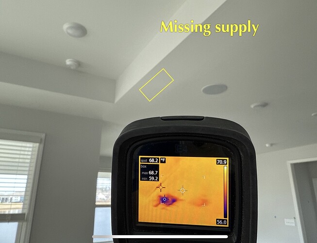

I find missing insulation on every new build. Every once in a while, I find an HVAC supply that never made it through the sheet rock.
Every single one!
Several times a year… a couple weeks ago I found a register boot installed with no duct connected.
