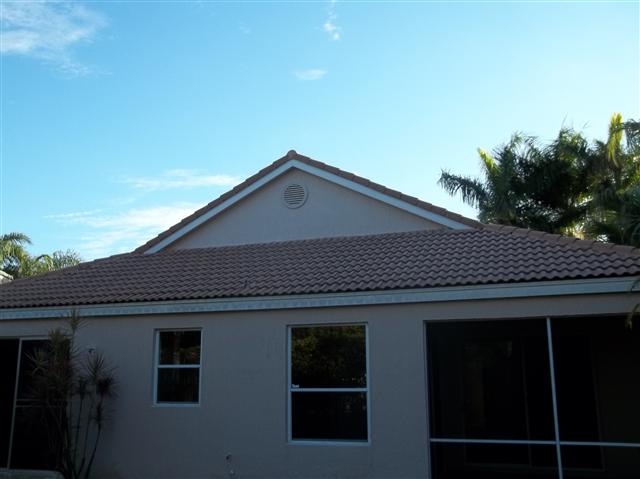

The pictures below are of the same house, but just pretend they are two different houses.
What type of roof is on the home, according to the form?

The form requires you to state the measurements of hip and non-hip shapes. You may get some rejections if you don’t put down the numbers.
The only time I would not fill in numbers is if it’s 100% hip. I’d write 100% on the form where it asks for a number.
Only requires measurements for hip or sqft for flat…other (or non-hip) doesn’t require it.
Thank you Preston…I am pretty sure that is what i said.
I thought so too…
Only if you are justifying a ‘Hip’ roof!
If you can see ‘Other’ roof shapes greater than 10%, mark ‘Other’ and move on.
I am pretty sure I said that too…:cool:
Yes you did, and so did Preston. I figured I’d say it one more time for an echo…:slight_smile:
