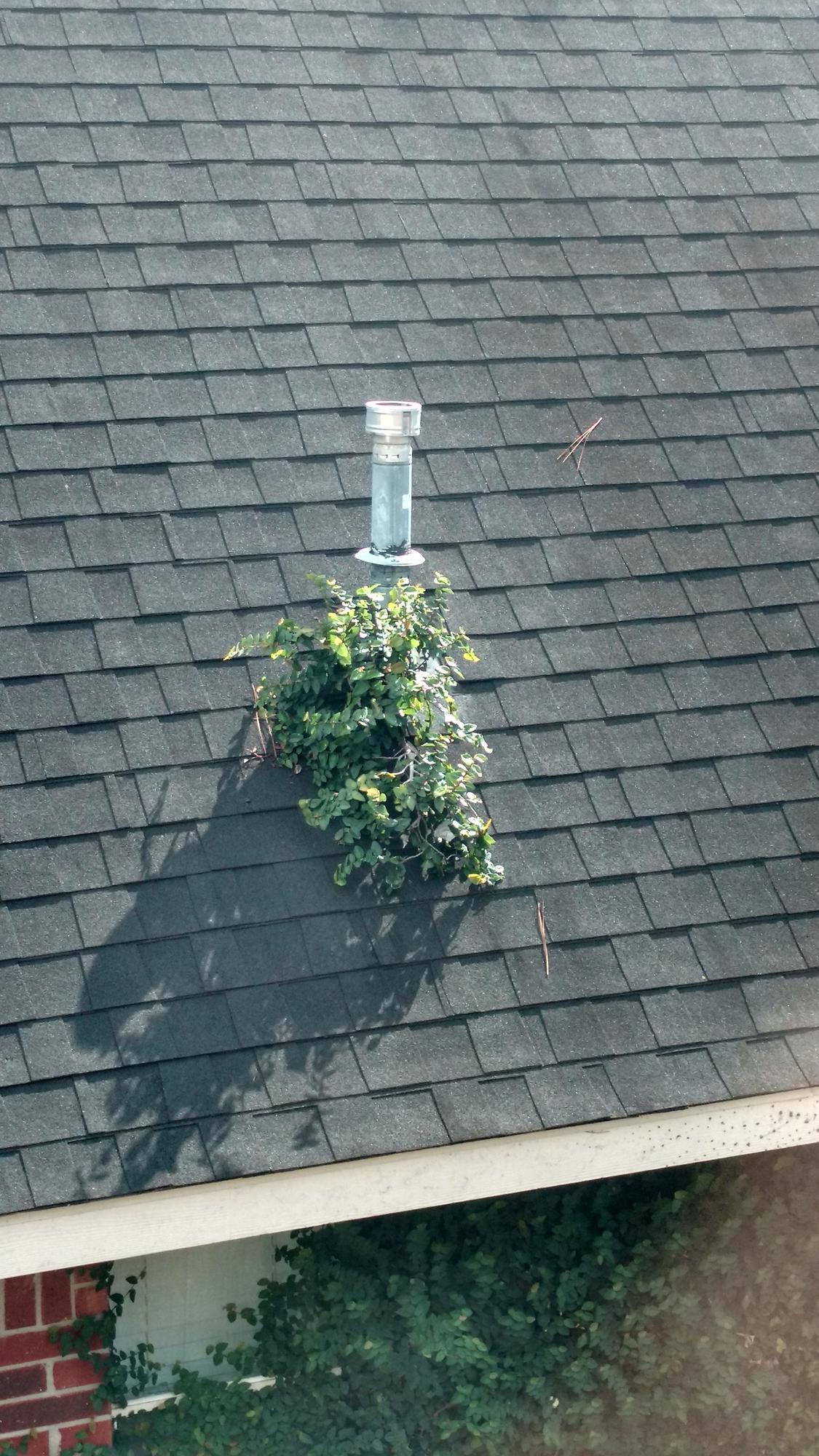

On a recent inspection I found vines from the side wall had continued to grow through the attic space and out the water heater flue vent flashing. Client was inform of the safety hazard and recommended to remove all vines from around flue and attic space. It was also recommended to remove all vines from the exterior wall to minimize moisture and pest entry.
