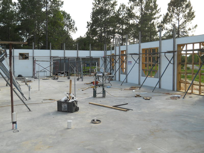

I have a Friend who is a Engineer here in Florida. And his and his best buddy who is an Architect are building this home.
I thought this would be a good time to take out the camera.
I asked them if they were going to do this by the book .
They said that this is going to be done picture perfect .
My Question is .
Would anyone be interested is watching this home go up?
I maybe biting of more that I can chew, But If it helps just one it would be worth it.
I plan on adding it to my library .
Here we go !
The slab is all poured next come the forms.

They will be putting in the receiving channel tomorrow.
If weather permits.

I’ve seen a few around my area; cost to build is higher than conventional homes but is more comfortable to live in and most likely cheaper to conditioned.

Ok its been a while since they went back to work on this project , but they are there full bore today.
Here is a few pics with more to follow .
The dowels are set a 4 ft centers. And at shot of the corner setup.
I built my basement out of ICF’s. I loved it. Easiest concrete work you will ever do. I had a contractor pour the footings, And from there it was a 2 day project. First day- install blocks 5 feet tall, with re-bar etc, and start window and door frames Second day, finish blocks, and pour concrete using pumper of course. Off the job about 6 pm, removed supports and cleanup.
The bracing is there to keep the wall plum as they pour the concrete.
They is adjustable .
The concrete gets poured Wednesday.
