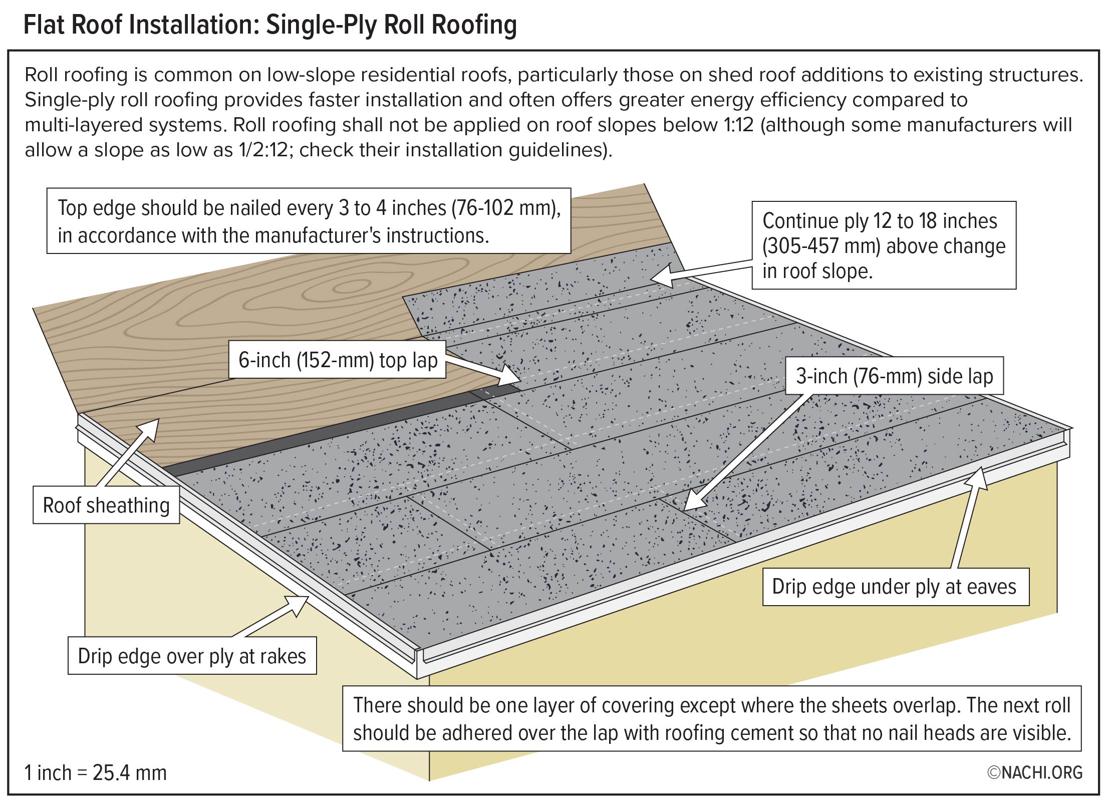

New image added to the free Gallery: Flat Roof Installation:Single-Ply Roll Roofing
Very nice.
Looks good.
We wouldn’t normally say “single ply” when referencing a rolled roofing such as a modified bitumen ply. So even if a single ply of rolled modified bitumen was observed, say on a residence, we would say one ply modified bitumen. The term single ply roofing is generally associated with EPDM, TPO and PVC.
Love these…keep ‘em coming!!
