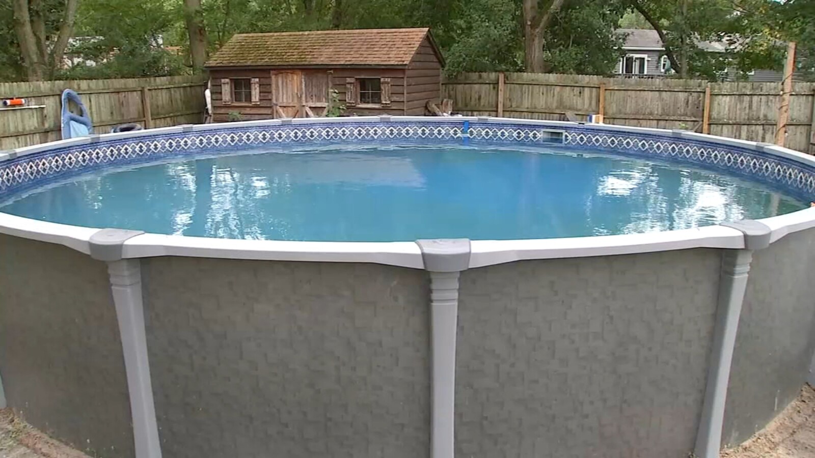

New Jersey pool/yard stray electricity mystery
Any pool experts think they could solve this grounding mystery? Head over to Brick, NJ asap!
Wonder if the issue exists with the power turned off to the pool pump?
They said the pool was investigated. I would turn off power at the pole (overhead SEC) and see if the problem persists. If it does, the problem is not coming from that house. I did notice a remote front yard light (must have an underground supply). I wouldn’t think the problem would be that hard to isolate. The power company can turn off everything as they desire.
Yea I was curious if it was indirectly related to the pool & equipment.
Could it be possible that there has always been some amount of stray electricity in the ground in that area coming from elsewhere, and the installation of the pool is conducting it and preventing it from grounding?

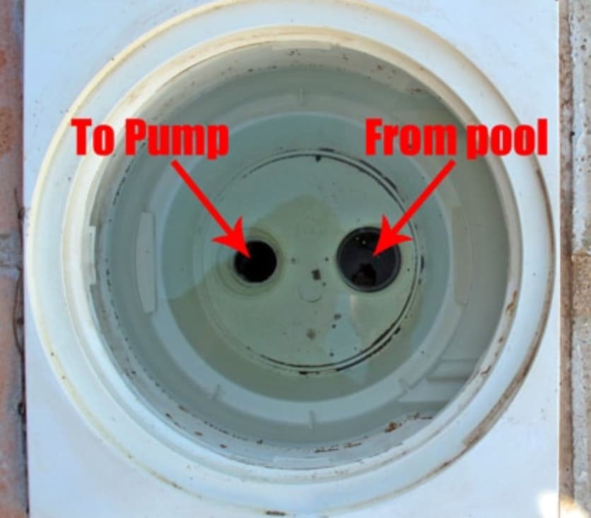

Skimmer has 2 wholes. One from pool other to pump. I would look for bonding straps and odd metal bonds.
