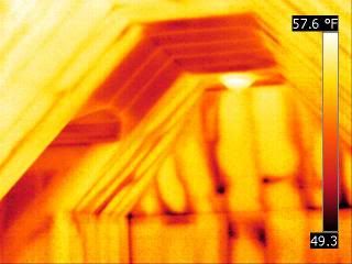

Where the hell are you coming up with this!? I detect it on almost every single house I inspect!
I see it with the camera, then go up and take a picture if it not happening!
I have been through lawsuits for my clients where engineers from the construction company verified my verifications!
I have municipal building code inspectors used my data and require contractors to correct the inadequate insulation job!
I have no earthly clue where you’re coming from!
The ceiling has missing insulation (0%) and far wall is not in contact with where it is supposed to be in contact with.
Inside view…

My statement regarding containment on all six sides of the insulation, and the IR camera’s inability to determine it, has to do with exterior walls on the first. second floor…not attic walls. As you can see from your regular photo, the insulation is in contact with the air barriers only on 5 sides.
